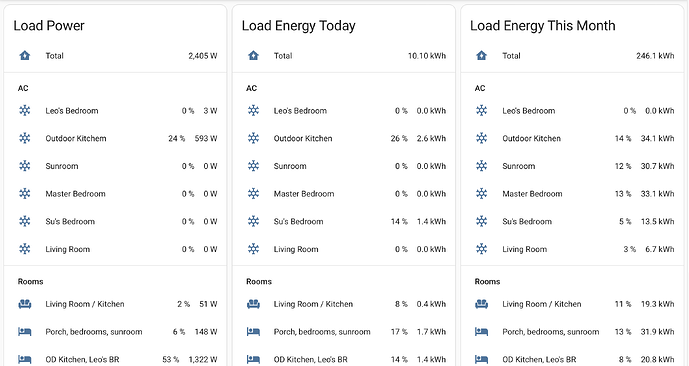

Can you show us the other tabs for your energy monitoring please. I’m intriqued
For energy monitoring I just have a screen full of multiple entity cards showing power, energy today, energy this month, and percentages of the total for each. The energy totals are from an Emporia Vue and a Shelly EM. I also have power flow and energy flow dashboards but I never look at them. They’re just the standard cards.
The more interesting dashboards (and automations) have to do with importing grid power. I monitor grid voltage and adjust how much power I am importing. This is necessary because our grid is incredibly fragile. It’s very easy to cause the voltage to drop so much that it causes problems.
