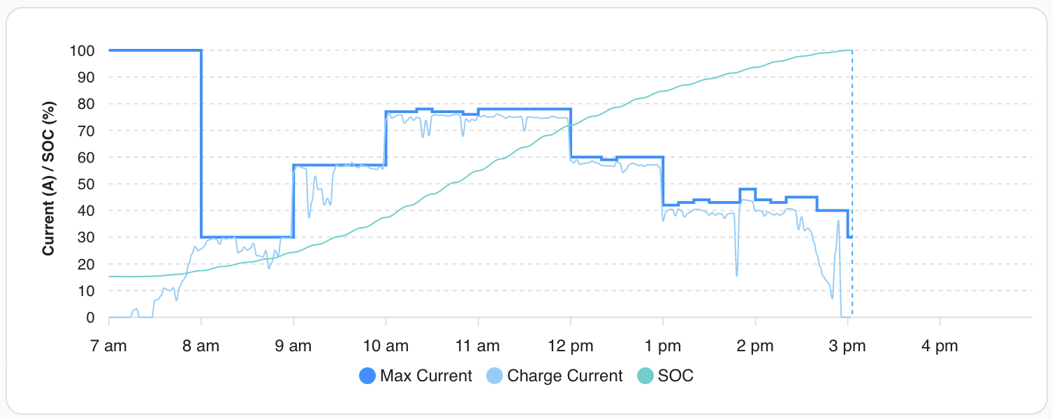

I’ve built a system for adaptively charging 20 kWh of battery storage. Why? Four reasons, in the order they occurred to me:
  1. When I first got my batteries, before I had “tuned” anything, my inverter would charge them to a ridiculously high level and then just hold that voltage for like 5 hours. There are no parameters in the inverter settings to control battery charging except “how fast do you want to charge?” 80A? 120A? 220A? It bothered me so much too see my batteries held at 57.6v for multiple hours every day that I started writing template sensors and automations to delay 100% SOC until later in the day so the batteries didn’t spend so much time at a high voltage level. This is no longer a reason but this is what started it.
  2. I’m in Thailand where a 15(45)A electrical service is typical. That’s 15A continuous at 220v, 45A peak, with aluminum wire from the pole sized to match, but I have a 10kW inverter with 12.7 kW of solar panels. I’m limited on how much power I can export by the meter and the wire. I figure 25A continuous is pushing it but the system can generate 50A on a good day. So one of the design goals is to maximize utilization by balancing grid export with battery charging.
  3. Although the primary motivation was to SLOW DOWN battery charging, there are also scenarios where I want to SPEED UP charging or otherwise maximize the capture of solar energy. For example, a day with sunshine in the morning but rain starting at noon. Or maybe a mostly cloudy day with intermittent patches of sun. Without this system I would set charging to .25c (100A). With this system I set maximum current to 220A, the limit of my inverter, DC breaker, and battery cables. I have seen with my own eyes peak PV power of 13.5k, so why not?
  4. I’m drawing a blank on the 4th reason. I’ll update this if I remember.
Some details of my system:
  • Deye 10 kW hybrid inverter
  • 12.7 kW of Longi solar panels (22 x 575)
  • 21.3 kWh of Seplos “powerwall” batteries
  • East facing on a very shallow slope roof, not that it matters
The system is composed of the typical things, of course: input_number sensors, template sensors, automations, entities cards, custom button cards,and apexcharts.
Oh, how is everything plugged in to Home Assistant:
  • Solarman integration for the inverter, connected via wifi
  • BMS Battery Management integration with an ESP32 configured as a bluetooth proxy
  • Solar Assistant via MQTT although I’m not really using it since I’m connected directly to the inverter and master BMS.
  • Solcast integration for solar forecasts. Without this it wouldn’t be possible.
  • Ecowitt weather station (informational, doesn’t drive the algorithm)
What else? What do you want to know?
  • I’m keeping track of load hourly for 3 days and using a 3 day running average in combination with the forecast to forecast “available” power.
  • Allocation “follows the solar curve”. This is key to allocating power between the batteries and export.
  • I ramp down maximum current starting at 85% so that my batteries aren’t getting 140A at 98% SOC. That actually happened.
  • I’m using a compromise between the “likely” forecast and the 10% “pessimistic” forecast. That’s what the “pessimism factor” is - it controls how much my forecast is biased toward the “likely” forecast or the “pessimistic” forecast.
  • An automation runs every hour to set a target hour. If the forecast changes, this is how I speed up or slow down charging.
  • Min and max charge rates are clamped. I played around with this a lot during development but now that the system is stable, they’re just set to 40A and 220A.
  • There’s a front-loading factor to prioritize early charging. Its exponential so more weight at 11 AM than at 1 PM.
  • There is a maximum target hour. Target hour is set hourly by an automation but I want to be able to limit how late in the afternoon it can go. I’ve found through trial and error that 3:00 is kind of the point where it becomes too late to reliably get the batteries charged to 100%. That’s where the lines for solar power and consumption cross with my east-facing panels.

# Calculate the charge current required to deliver the allocation_this_hour amount of energy
# in the time remaining in the hour.
# This sensor is what is used in the automation to set sensor.deye_max_charging_current
# input_number.abc_max_charge_rate is now wrapped in a template sensor to ramp down charge rate
# above 90% SOC.
    - name: "ABC Max Charge Current"
      unique_id: abc_max_charge_current
      unit_of_measurement: "A"
      device_class: current
      state_class: measurement
      availability: >-
        {{ has_value('sensor.abc_allocation_this_hour') }}
      attributes:
        comment: "This number is used in the automation to set sensor.deye_max_charging_current"
      state: >-
        {% set allocation = states.sensor.abc_allocation_this_hour.state | float %}
        {% set time_fraction = ((60 - now().minute) / 60) | round(2) %}
        {% set battery_voltage = states.sensor.deye_battery_voltage.state | float %}
        {% set min_charge_current = states.input_number.abc_min_chg_rate.state | float %}
        {% set max_charge_current = states.sensor.abc_max_chg_rate.state | float %}
        {# Round charge current to 5A to reduce the frequency of history update and clamp between min and max #}
        {% set charge_current_raw = (allocation * 1000 / time_fraction / battery_voltage) | round(0) %}
        {% set charge_current = ((charge_current_raw + 2.5) // 5) * 5 %}
        {% set charge_current = min(max_charge_current, charge_current) %}
        {% set charge_current = max(min_charge_current, charge_current) %}
        {{ charge_current }}
        {% set debug=0 %} {% if debug %} Max Charge Current Calc:
        Allocation: {{ allocation }}
        Time Fraction: {{ time_fraction }}
        Battery Voltage: {{ battery_voltage }}
        Charge Current Raw: {{ charge_current_raw }}
        Charge Current: {{ charge_current }}
        {% endif %}

The latest iteration of the dashboard. State values in the header of an spexchart don’t update as frequently as I like so I moved them into custom buttons cards.
This automation has been running hands-off for awhile now. There were weeks where it never went a day without something changing, but it’s finally working well. It’s adjusting nicely to changes in the forecast. I’ve seen quite a few marginal days lately and it has handled those nicely as well. It’s cool to see the batteries able to take in all 140A of a break in the clouds for 20 minutes, where without the automation I would limit the charge rate to 80A.
A picture perfect day for the adaptive battery charging automation, finishing within minutes of the target time. Current was allocated perfectly each hour. When we get approved to export excess power, this will maximize output of the system by allocating power between load, battery charging, and export which does not exceed the capacity of the utility meter and wire.
My latest enhancements is looking at how much variance there is in solar radiation (as a proxy for solar production, which is curtailed because I can’t currently export power) and giving a boost to max charge current so that I’m not always just reacting to to not getting as much energy into the batteries as I expected. The algorithm works without this, but with it there is a more constant allocation of power. Worked to perfection today.

    # Calculate total "available" solar energy as the net of the solar forecast - estimated consumption
    # This is a special purpose sensor, used in only *ONE PLACE*, the calculation of the remaining
    # allocation for the current hour. That sensor does not order through the entire forecast so it
    # needs this total.
    # DO NOT USE IT ANYWHERE ELSE unless you are REALLY sure it's what you want.
    - name: "ABC Available Solar Energy"
      unique_id: abc_available_solar_energy
      device_class: energy
      unit_of_measurement: "kWh"
      state_class: total
      icon: mdi:solar-panel
      availability: >-
        {{ has_value('sensor.abc_hourly_forecast') and
           has_value('sensor.abc_home_loads') }}
      attributes:
        comment: "Available solar energy after estimated home loads subtracted"

    # Calculate how much energy we want to add during the remainder of the current hour
    # Allocation counts down during the hour since it's the allocation 'remaining' this hour
    # It's aspirational, not a prediction
    # *** This is the core calculation *** Most other sensors are "input" to this calculation.
    - name: "ABC Allocation This Hour"
      unique_id: abc_allocation_this_hour
      state_class: total
      icon: mdi:lightning-bolt
      availability: >-
      attributes:
        comment: "Calculates energy remaining to add to the battery during the current hour"
        energy_needed: "{{ states('sensor.abc_energy_needed') }}"
        energy_available: "{{ states('sensor.abc_available_solar_energy') }}"
      state: >-
        {% set current_hour = now().hour %}
        {% set target_hour = states('input_number.abc_target_hour') | float(-1) %}
        {% set energy_needed = states('sensor.abc_energy_needed') | float(-1) %}
        {% set energy_available = states('sensor.abc_available_solar_energy') | float(-1) %}
        {# Allocation only makes sense prior to the final hour and when excess energy is available #}
        {% if (8 <= current_hour < target_hour) and (energy_needed < energy_available) %}
          {% set minutes_remaining = 60 - now().minute %}
          {% set forecast = state_attr('sensor.abc_hourly_forecast', 'forecast') | default([]) | list %}
          {# Adjust the current hour forecast by the estimated home load #}
          {% set h = states('sensor.abc_home_loads') %}
          {% set home_loads = (h if h.startswith('{') else '{}') | from_json %}
          {% set home_load = home_loads.get(now().strftime('%H'), 0) | float %}
          {% set current_hour_forecast = forecast[0].pv_estimate | float %}
          {% set current_hour_forecast_net = current_hour_forecast - home_load %}
          {# Energy needed declines while the proportion remains the same, resulting in a declining #}
          {# stairstep pattern each hour. Subtract out energy for the portion of the hour that has  #}
          {# passed from both the numerator and denomenator to calculate an adjusted proportion.  #}
          {% set hour_fraction_past = (60 - minutes_remaining) / 60 %}
          {% set adjustment = current_hour_forecast_net * hour_fraction_past %}
          {% set adjusted_current_hour = current_hour_forecast_net - adjustment %}
          {% set adjusted_energy_available = energy_available - adjustment %}
          {# Calculate proportion based on adjusted values and clamp between 0 and 1 #}
          {% set energy_proportion = adjusted_current_hour / (adjusted_energy_available + 0.01) %}
          {% set energy_proportion = [0, [ 1, energy_proportion ] | min ] | max %}
          {# Calculate how much energy to allocate to the remainder of the current hour #}
          {% set allocation = energy_needed * energy_proportion %}
        {% else %}
          {% set allocation = energy_needed %}
        {% endif %}
        {{ allocation | round(2) }}
    # *** This sensor is what is used in the automation to set sensor.deye_max_charging_current ***
    # above 90% SOC.
      availability: >-
      state: >-
        {% set allocation = states('sensor.abc_allocation_this_hour') | float(0) %}
        {# If past target_hour, try to finish charging in the next 15 minutes #}
        {% set time_fraction = (0.25 if now().hour >= target_hour else (60 - now().minute) / 60) | round(2) %}
        {% set charge_voltage = states('sensor.abc_charge_voltage') | float(-1) %}
        {% set min_charge_current_limit = states('input_number.abc_min_chg_rate') | int(-1) %}
        {% set max_charge_current_limit = states('sensor.abc_max_chg_rate') | int(-1) %}
        {% set max_charge_current_now = states('number.deye_battery_max_charging_current') | int(-1) %}
        {% set boost = states('sensor.abc_solar_variability_boost') | float(1.0) %}
        {% set charge_current_raw = allocation * 1000 / time_fraction / charge_voltage %}
        {% set charge_current_boosted = (charge_current_raw * boost) | round(0) %}
        {% set charge_current = max(min_charge_current_limit, charge_current_boosted) %}
        {% set charge_current = min(max_charge_current_limit, charge_current) %}
        {% set debug=0 %}{%- if debug %}Max Charge Current Calc:
        Allocation This Hour: {{ allocation }} kWh
        Time Fraction: {{ time_fraction }} h
        Charge Current Raw: {{ charge_current_raw | round(0) }} A
        Solar Variability Boost: {{ states('sensor.abc_solar_variability_boost') }}
        Charge Current boost: {{ charge_current_boosted }} A
        Min Charge Current (Limit): {{ min_charge_current_limit }} A
        Max Charge Current (Limit): {{ max_charge_current_limit }} A
        Max Charge Current (Now): {{ max_charge_current_now }} A
        Max Charge Current (Next): {{ charge_current }} A
        {% endif %}

  - alias: "ABC - Adaptive Battery Charging Controller"
    mode: single
    description: "Adjust charge current so that the battery doesn't reach 100% SOC until target_hour"

      - action: timer.start
          entity_id: timer.abc_countdown_timer
        # Set the adjusted Max Charging Current
      - action: number.set_value
          entity_id: number.deye_battery_max_charging_current
          value: "{{ states('sensor.abc_max_charge_current') }}"
        # Because the real Max_Charging_Current gets set to 200A every 15 minutes, this messes up
        # our dashboard chart, so create a clean version containing just our changes for the chart
      - action: input_number.set_value
          entity_id: input_number.abc_battery_max_charging_current
          value: "{{ states('number.deye_battery_max_charging_current') }}"

A few things I’ve learned along the way.
  1. I start with something very close to the “10%” forecast. It’s always possible to slow down but not always possible to catch up. The forecast gets updated every hour so there’s less and less uncertainty as the day wears on, so starting near 10% simply “front loads” charging.
  2. I tried delaying 100% until late afternoon but it gets real sketchy so now I’m usually targeting 3 PM and that’s trending toward 2 PM as I’ve lowered the target voltage quite a bit so I’m no longer as concerned about holding a high voltage for a few hours, so erring on the side of getting the batteries charged is making more sense.
  3. This automation was originally about slowing down charging but the ability to speed up charging has been the difference between getting the batteries charged and not getting them charged on a few occasions. For example there’s bright sunshine until 11 and then rain. Being able to charge at maximum speed has been very useful. I’d prefer not to charge at near .5C but I will if I need to.
  4. I’m now supplementing solar with grid power if the forecast is for the batteries to not get charged. That’s a separate automation that doesn’t interfere with this one. The batteries don’t care where the power comes from. I have to do this because grid power is available during the day but the grid can be extremely fragile in the evening. If we run out of battery power before about midnight, we can suffer brownouts as the grid voltage falls to 10% below nominal.
  5. Putting info in attributes for easy inspection from the dashboard has been super helpful in figuring out why a sensor has the value that it does.
  6. Putting debug code right in state has been super helpful. Just copy state into the template tester and change debug = 1 and all of the local variables are right there for inspection.
Thank you very much !! I will try to adapt it to my particular situation. My goal is to optimice the battery load based on forecast data and electricity prices. I had a look at EMHASS but it seems hard to configure. Thanks again!
If you have any suggestions for how to make this more “presentable” I’m open to suggestions. I think a listing of what sensors are needed at the top might be useful. ChatGPT might be able to compile that list for me.
