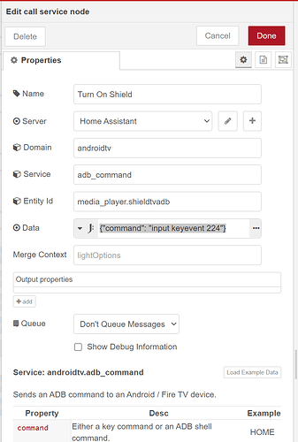

My automation is built in Node Red and its not using any crazy 3rd party intergration I an using a generic Call Service Node.
So my previously working node was
Call Service Node;
Name: Turn On Shield
Server: Home Assitant
Domain: androidtv
Service: adb_command
Entity ID: media_player.shieldtvadb
Data: expression {“command”: “input keyevent 224”}
If I trigger this manually with an inject node I get an error.
I tried changing this around in a million ways, including trying simpler commands like just “POWER” and I still get an error.
On the debug for Node Red the error I am getting sounds strange.
“Calls to RED.util.evaluateJSONataExpression must include a callback.”

Update:
Figures I figured it out myself just after posting.
I actually didnt find that error message in node red until just when I posted, when I googled that I found a reference to an out of date websocket plugin for Node Red.
Going into my palet manager and updating all of them fixed the issue.
