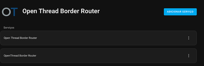

I’ve tried forking the original add-on repo and successfully installed a 2nd add-on on Home Assistant, but it didn’t work because OTBR forces port 8081 for the REST API. So, for now, it’s impossible to have 2 instances running on the same server.
I solved the problem by using a standalone Docker image on a VM using Portainer that replicates the HA add-on: GitHub - ownbee/hass-otbr-docker: Stand-alone Home Assistant OpenThread Border Router docker container.

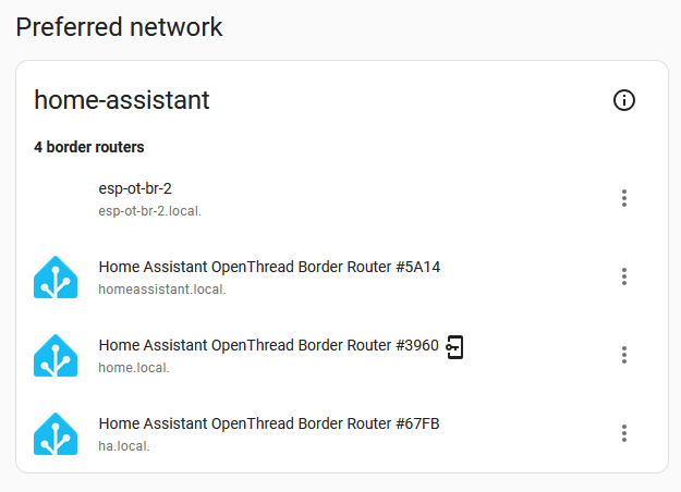

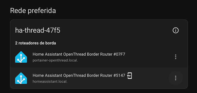

Now I have 2 OTBR integrations:
And two border routers on the same Thread network:
Previously paired devices are working, but now I’m struggling to add a new device to this 2-router setup.

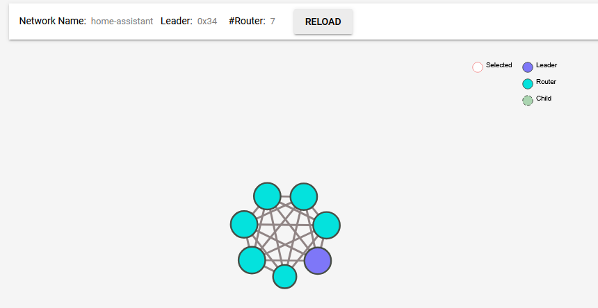

Where can I find this visualisation of my thread network? Is that HA or one of it’s add-ons?

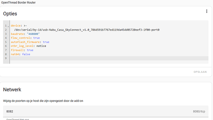

Openthread border add-on settings:

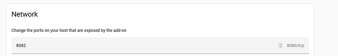

So I just go to http://10.0.0.66:8082
I didn’t change the default port, so it should be 8080. But how do I find the correct IP address? Is it the IP address of your HA instance? I don’t find it in my Openthread border add-on settings.
Yes, it’s HA instance IP if you are using the add-on. It defaults to port 8080. Unfortunately, most of the time it displays an incomplete network.
Hmm… I’m getting a connection refused when I go to http://192.168.3.xx:8082.
I use the add-on (not in a separate docker container). Other add-ons that have a web-ui just have a button like this, but this is also missing.

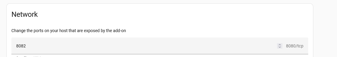

My settings are pretty default:
That usually happens when you are reaching a valid address, but the socket is either not open, or ?perhaps it is already in use by another server for another use?
Maybe try a more random 8xxx port number.
Thanks that worked! I guess many ports already in use on my instance.
And the OpenThread UI is indeed pretty limited.
