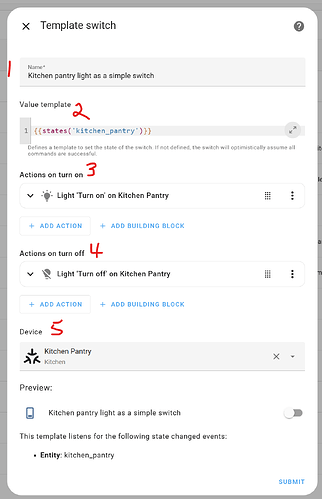

Here’s an update to my prior solution that involves much less YAML coding. I find it easiest to keep two browser windows / tabs open to do this.
  1. In browser 1: find a light device that you want to change.

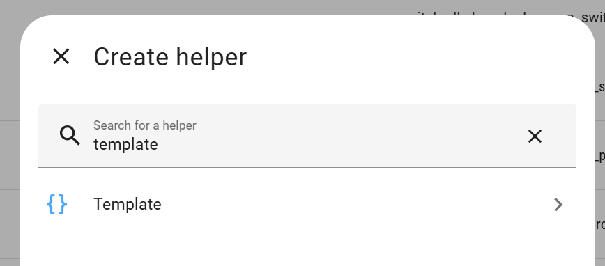

  1. In browser 2: Navigate to: Settings → “Devices & services” → Helpers, and choose the “Create Helper” button in the lower-right corner

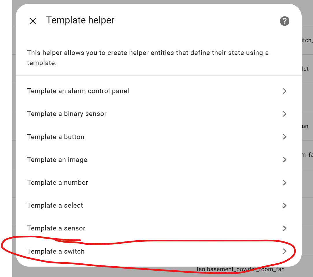

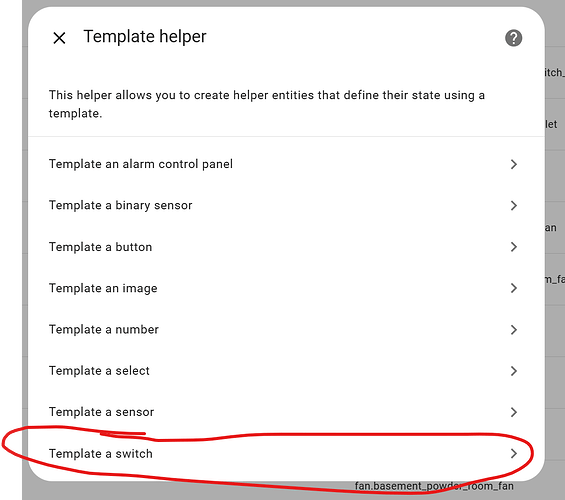

  2. Find the “Template” helper:
  3. And choose “Template a switch”
  4. Fill in the name (1), value template (2), On / Off actions (3), (4) and the related device (5).
For (1), pick any name. For (2) the “states” template should use the entity name for the light entity from step 1. For (3), (4) just set to turn on and off the original light entity, and in (5) pick the original light device from step (1) and the new entity will link to and appear inits Control section.

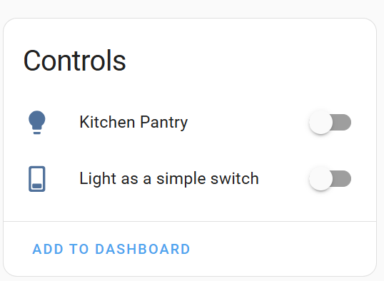

  1. The original light control from step 1 will now have an added switch control.
  2. If you want, you can hide the light control by turning off its Visibility and can also change the “Show as” for the switch by clicking on the switch entity, then the gear icon, then changing the “Show as”
