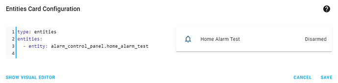

I have a manual alarm alarm_control_panel and have added the entity [alarm_control_panel.home_alarm] as a badge in my lovelace. When you click on this, you can choose 2 options: ARM AWAY and ARM HOME. I would like to add the option ARM NIGHT to the buttons. Is that possible without using the various (custom) alarm panel cards?

Edit the card in the lovelace UI configuration . Then click the “available states” drop down and select armed_night. It will show up
Just checed the card config (default entities card) but I can’t find an option to choose “available states”
The reason for using (in this example) a default entities card is that I have the alarm as a badge on my main view. I’d rather not have a dedicated alarm card (where it is indeed possible).

Click on the SHOW VISUAL EDITOR button.
Or fill in these lines :
type: alarm-panel
states:
  - arm_home
  - arm_away
  - arm_night
entity: alarm_control_panel.alarm
This works but its not adding the buttons to overview, is there anyway to make the change apply system wide?
