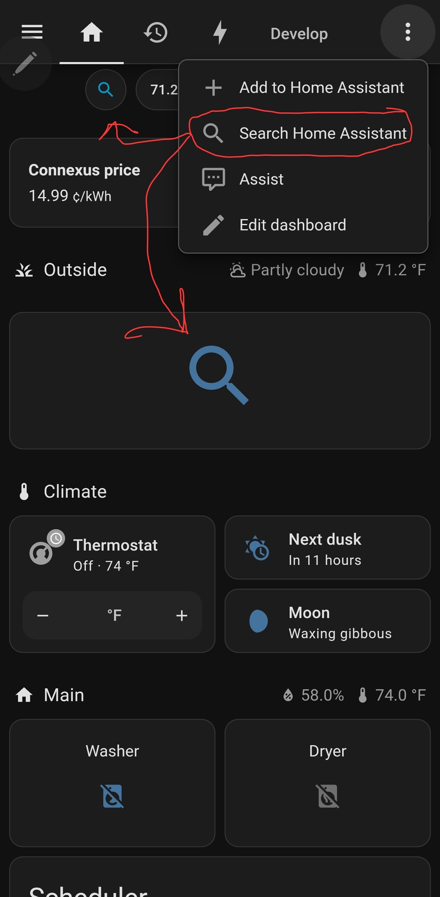

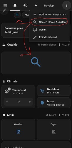

How can I add a button/badge to bring up "Search home assistant" on a custom dashboard? This is for easier access from mobile app, where currently search is under a submenu.
I tried searching Google, Home Assistant Forum, ChatGPT, and Claude, and suspect it's impossible without modding? Hopefully I'm missing something simple. It see it's very easy to add a shortcut to "Assist", but can't figure out how to do it for "Search".
I tried a Button with action Navigate and destination /search , but that didn't work. Nor did /?search. The search seems to be a popup, and inaccessible from a URL. I guess explains why "Assist" is not part of the Navigate action, either.
Fwiw I tried swiping down with three fingers, too, but that's also not working. Swiping up with three fingers triggers the server selection (even though I only have one server). But swiping down with three fingers just scrolls.
