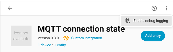

HACS > mqtt_connection state > three dots menu > redownload > different version > beta-0.3.1pre > restart.
You will get an alert that there is a new version available; this always triggers if the version you installed (beta-0.3.1pre) does not match the last release (beta-0.3.0). Just ignore it.
If the error is still there, can you please send me your debug log?
Settings > Integrations > mqtt_connection_state > three dots menu > enable debug logging.
Do a restart, wait for the sensor to say “Disconnected”, then click Disable, and a log will be downloaded. Please send me that file, so I can evaluate the messages received.
