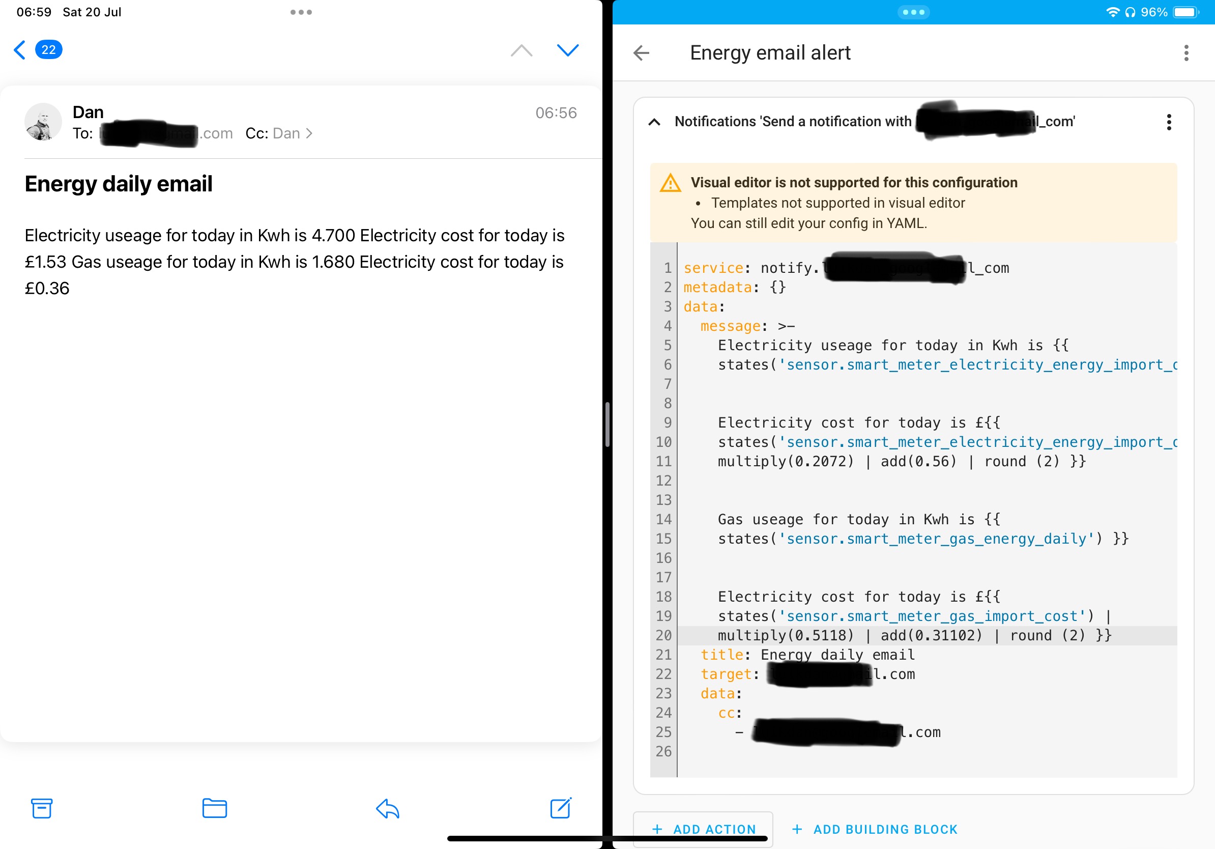

I am sending myself an end of day email with my energy costs using the notify gmail service. I would like to add a like break after the electricity costs but cant find any way to do this.
I believe this notify service sends in a plain text format so I dont think html tags will work.
If anyone can confirm if this is possible or not that would be great (and how would be amazing lol).
Code and output below.
Thanks very much Dan
Change this:
message: >-
To this:
message: |

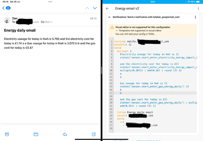

Massive thanks for the quick reply. Had a good read and play with the interactive article. Sadly does not change the behaviour I am seeing in the email output. See updated pic.

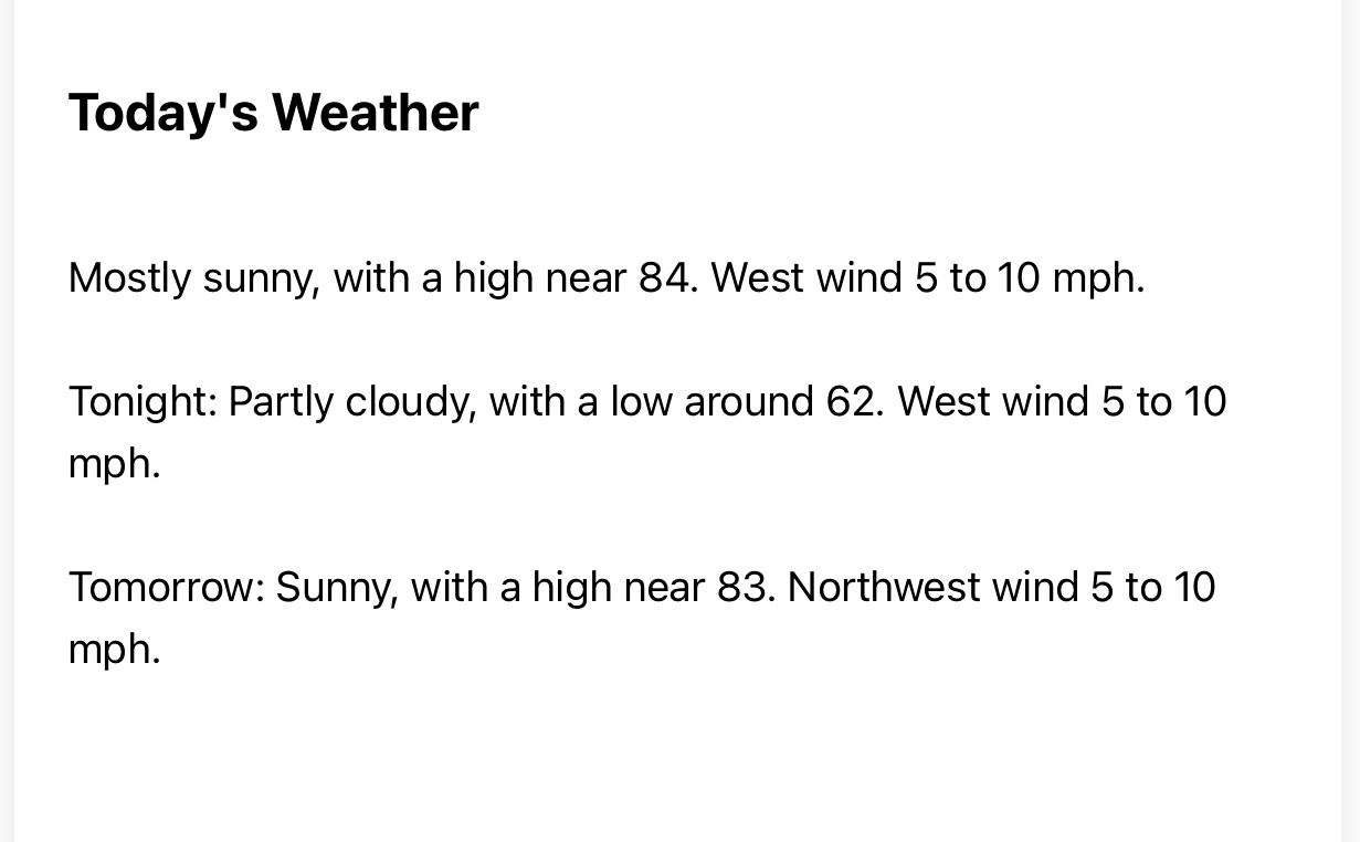

Thanks for the reply - just tried this but not joy. Best guess its the gmail service that does like formatting. Are you sending email using a different service to gmail out of interest? Thanks again. Dan

Try replacing ā€˜\n’ with ’ < br>'.
Incredible - this worked!
