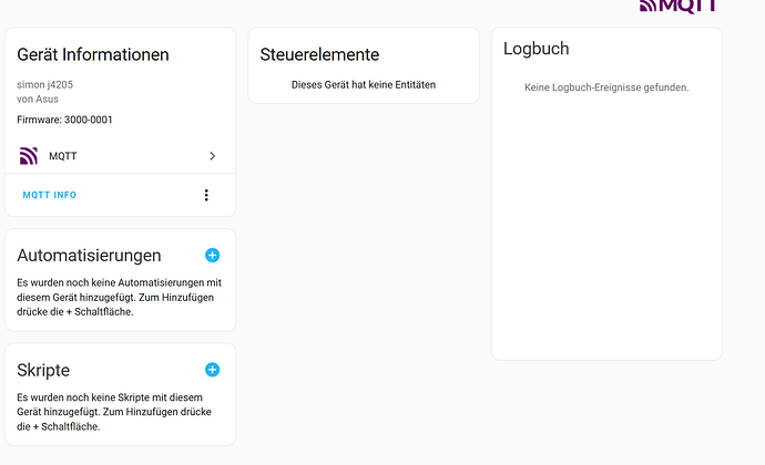

Now I can see the device, but there are no entities. How to add them?

Many thanks. I now published:
"availability": "simon-server/acpitz-acpi-0/online",
"device": {
"identifiers": [
"acpitz2"
"manufacturer": "Asus",
"model": "simon j4205_",
"name": "cpu_temp",
"sw_version": "3000-0001"
"device_class": "temperature",
"enabled_by_default": true,
"json_attributes_topic": "simon-server/acpitz-acpi-0",
"name": "simon cpu temperature",
"state_class": "measurement",
"state_topic": "simon-server/acpitz-acpi-0",
"unique_id": "cpu_simon",
"unit_of_measurement": "°C",
"value_template": "{{ value_json.temp1 }}"
but still have this:

I don’t think you understood me (and I made a mistake myself, should be availability_topic)
This is a working example (with abbreviations)
"uniq_id": "mqtt_sensor.temperature_humidity_sensor_0ef5_humidity",
"name": "Temperature Humidity Sensor 0Ef5 Humidity",
"stat_t": "ha_stream/sensor/temperature_humidity_sensor_0ef5_humidity/state",
"json_attr_t": "ha_stream/sensor/temperature_humidity_sensor_0ef5_humidity/attributes",
"avty_t": "ha_stream/sensor/temperature_humidity_sensor_0ef5_humidity/availability",
"dev_cla": "humidity",
"unit_of_meas": "%",
"stat_cla": "measurement",
"dev": {
"mf": "Xiaomi",
"mdl": "LYWSD03MMC",
"name": "Temperature/Humidity Sensor 0EF5",
"ids": [
"A4:C1:38:14:0E:F5"
Also, look in your HA log for possible errors.
