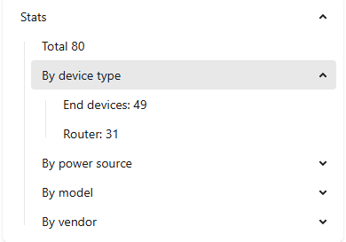

Do you have to do this for each device, or is it a global option?
Way cool, thanks!
I’ve added it. It counts to 61, while z2m shows 80.
What can that be?
@mhoogenbosch This template sensor counts devices whose “via_device_id” attribute matches ‘Zigbee2MQTT Bridge’ or whatever the name of your zigbee radio is if you’ve changed it. If the count you’re getting is less than that shown in Z2M, then you have z2m devices whose ‘via_device_id’ attribute doesn’t match for some reason. You would need to investigate that on your end, as I can’t tell you why that would be. The code below will give you the “via_device_id” attribute for any entity when you paste it into the template section in developer tools. That might help you locate Z2M devices that don’t match for whatever reason and go from there.

Right, thanks! I’ll look into it.
