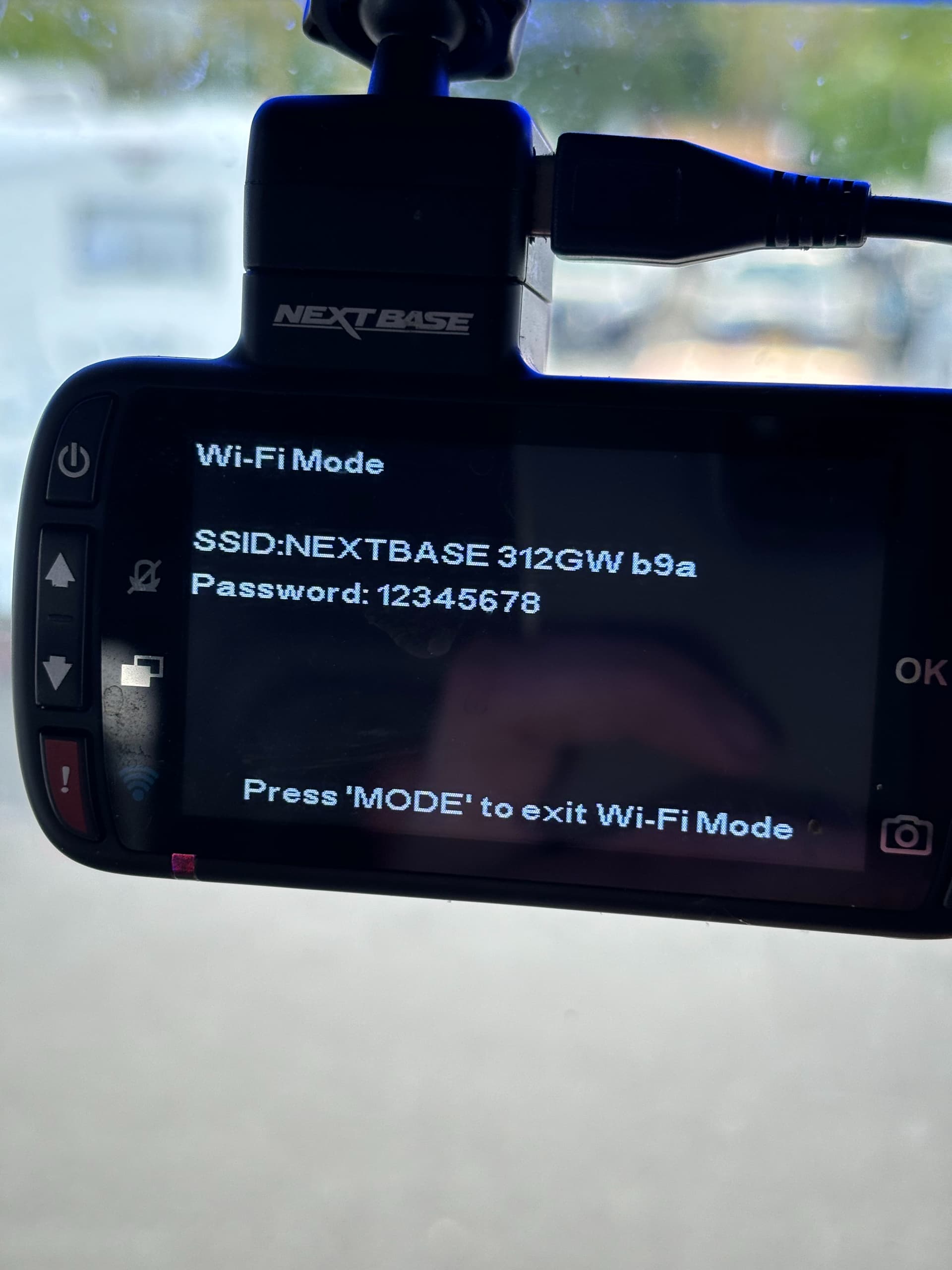

The camera has a so called ‘WiFi mode’ it acts as a access point for a so called ‘WiFi-Direct’ or WiFi-p2p connection.
In WiFi mode the port 554 is opened on the 312gw supporting the rtsp protocol:
rtsp://192.168.42.1:554/live
If i connect my laptop directly to my camera, its possible to view the livestream in VLC.

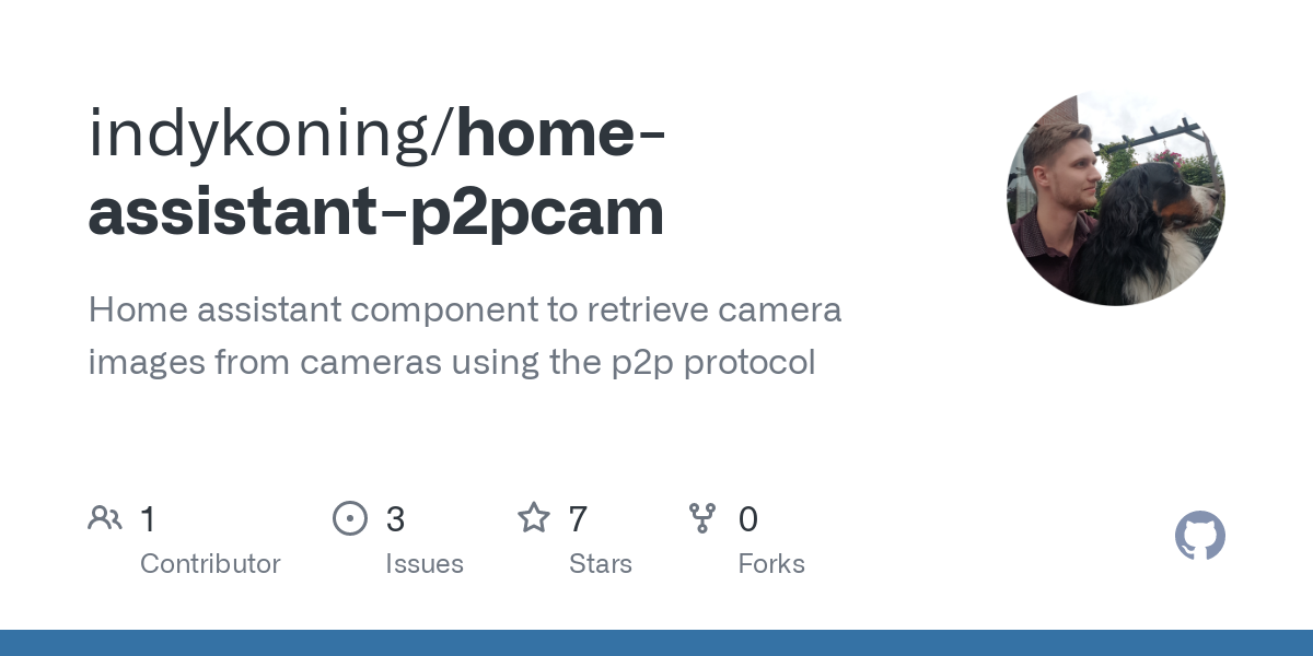

Found this project:
But didn’t succeed to establish a connection over wlan between the Raspberry and the Nextbase camera. Maybe because the wifi connection to the camera needs a password.
