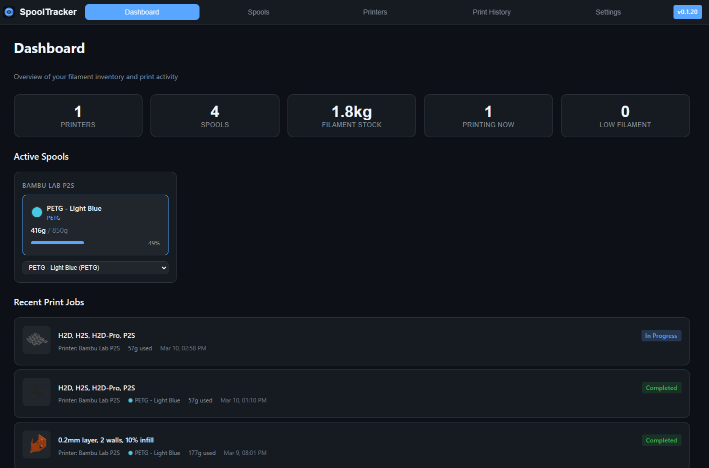

  • Spool management: Add, edit, archive, and delete filament spools with color, type, weight tracking, and remaining filament progress bars.
  • Automatic print logging: Detects print jobs from Bambu Lab printers via the HA integration and auto-logs project name, thumbnail, and filament used.
  • Automatic filament deduction: When a print completes, the used filament is deducted from the assigned spool; supports manual deductions for failed prints or calibration runs.
  • Multi-printer support: Tracks multiple Bambu Lab printers, auto-discovered from Home Assistant.
  • Dashboard UI: Overview of filament stock, active prints, low-filament warnings, and recent print history.

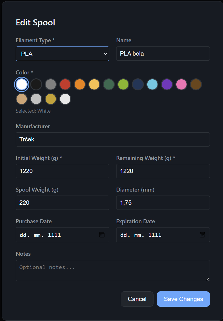

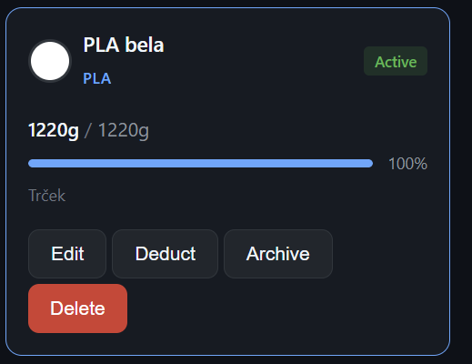

Hi! Thanks for explaining. The reason i’m asking is because either i’m doing something wrong or i understand wrong; namely, in my case i know empty reel weight and it’s not deducted from initial weight i enter:
i enter this for new reel:
but i get this on “Spools” page:
I guess this should state 1000g/1000g ? Or am i understand wrong?

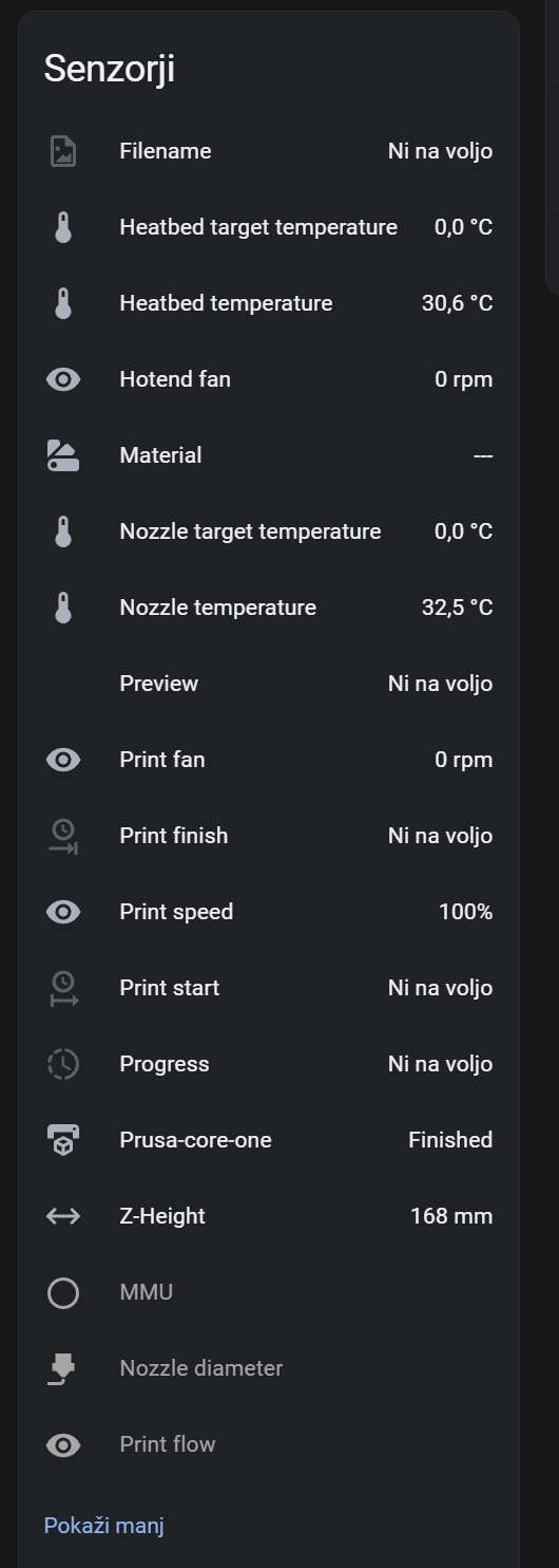

  1. regarding Prusa: when re-thinking, i think that perhaps Prusa is not yet ready for this, since i don’t see any weight info on my Prusa page. It contains print status, temperatures, job name, but not weight. Does Bambulab has this info in HA?
  1. Oh, I see, the field ‘Spool Weight (g)’ is optional and, looks like, a bit confusing. This field is not used in calculations. So, you should input just filament weights (Initial Weight and Remaining Weight, both in your case 1000g).
  2. It looks like Prusa is not yet ready for this Addon, but you can still add prints manually, so, you’ll still be able to track remaining filament.

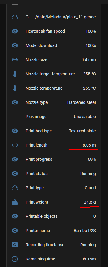

    Bambulab has this info in HA (it even has Print length for some reason)
Probably, you can request to add such sensor in the Prusa’s repo or related topic
