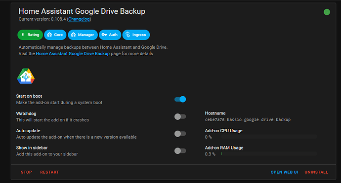

In HassOS on RPi, in the ‘Logs’-section, you should add a ‘back’-button. If it’s already there, I can’t find it
Here ?

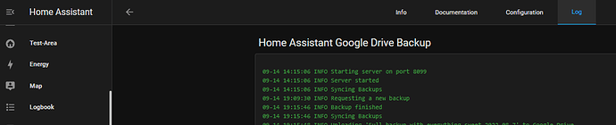

or do you mean once you open the web gui:
Because when I go to ‘logs’
I get the logs opened up in a new window so no need to hit ‘back’.
Uuhm, yeah, sorry, my mistake. A new window magically appears, didn’t notice that earlier
