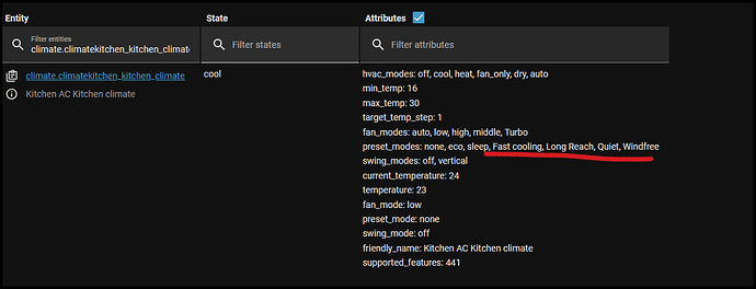

If you go to Developers Tools → States and find your Climate entry, does it show any preset modes like this?
Hmmm, I don’t have that entry. Will take a closer look
Any update regarding this topic?
I ended up with custom modes with spaces in names, and now I cannot use the custom card mode JS with them.
Does anyone know how to rename them, or where they are?
UPD: My bad, I forgot the ESPHome config section:
