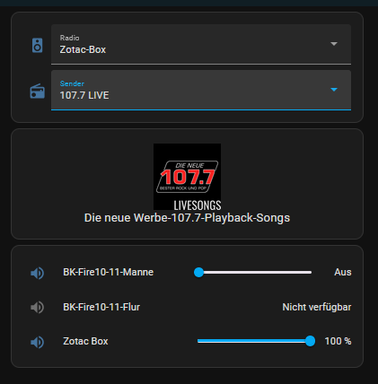

find it funny to promote theyre solutions behind a $0 paywall to what ever gain they may get by that, probably my user data or i dont know, i thought i just post the code for my music button cards with a screen shot beside it and make it for the next guy a easy copy paste thing to get em startetd.
ive just put in my favorite station and my not so much favorite station from here around Stuttgart Germany that are greeting me in my car via DAB and therestrical.

the pictures reside in /config/www/media/picturename.extension
and thats NOT the same as the media folder of home assistant!!! one could also use the direct uri to the stations logo on theier side to get updates, as SSL for example changes the logo on a regular base.
and her the helpers:
and
as you can see i also added two dropdown helpers (input_select) for “radio/speaker-device” and “sender/station-selector” and populated them. My code obviously needs adjustments for your stations, but if you copy it 1:1 and reporoduce my helpers, its working out of the box, then you can go from there.
I made the buttoncard fully flexible. short press starts the selected station on the selected device, long press stops playback on the selected device.
I was unable to reproduce the automation on the volume sliders though, some input here would be apreciated…

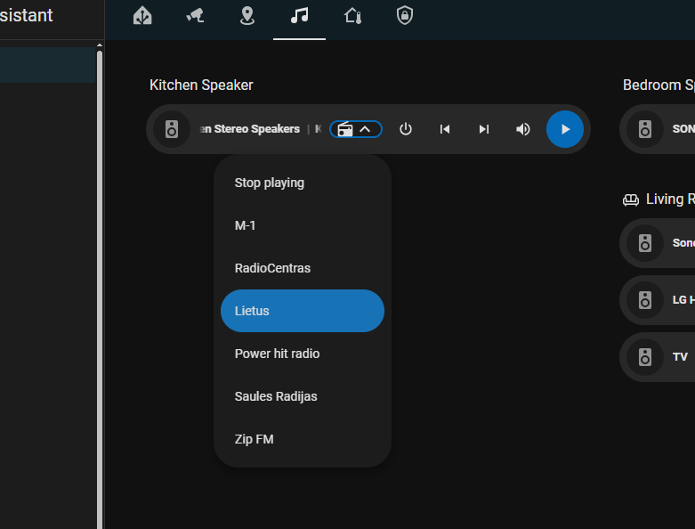

My suggestion is to use scripts or automations to trigger wanted radio station and then use dropdown card to list those stations.
