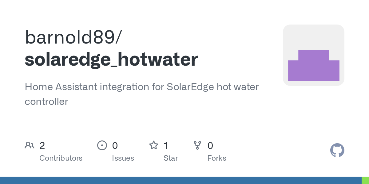

If anyone is still looking for a way to integrate the HotWater Controller into HomeAssistant. I found this recently and it works nice for me.
