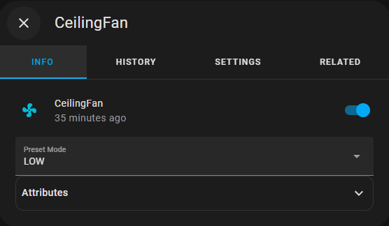

So I have the fan showing up as a fan, and the LOW/MEDIUM/HIGH/MAX settings as the app exposes:
