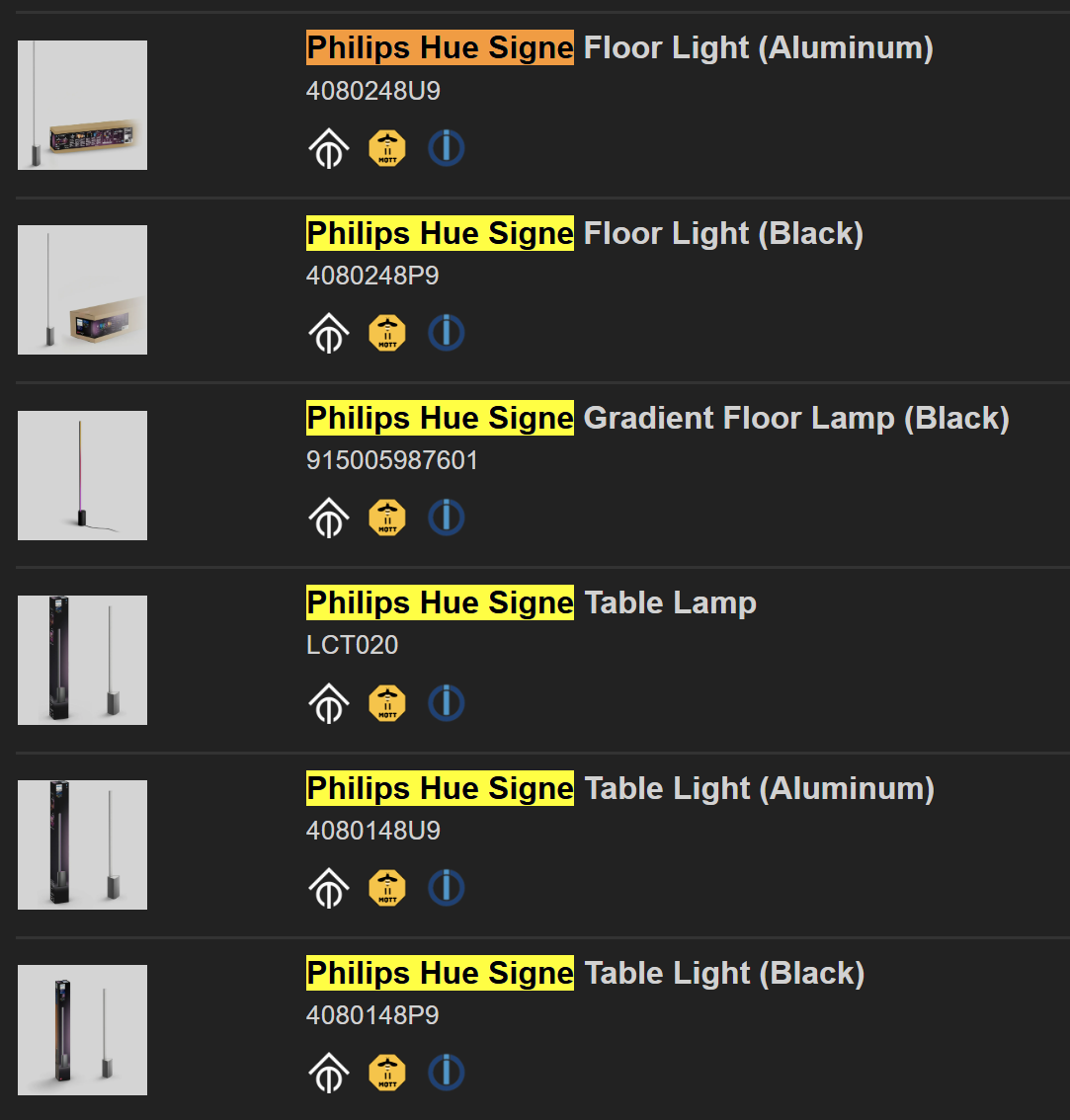

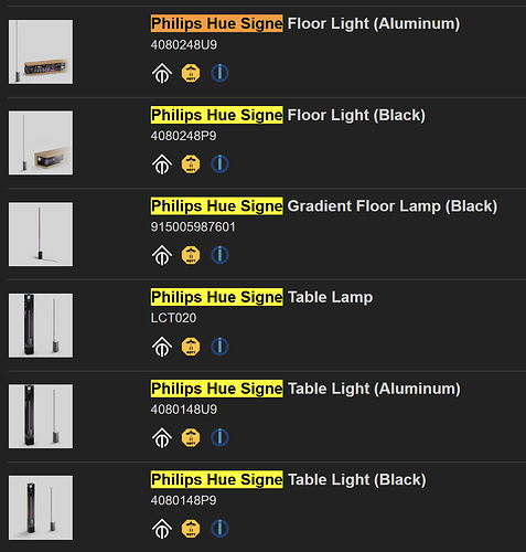

Is there a solution for this yet in ZHA? Seems Z2M supports it with colors, but I’m not sure how you’d set that from Home Assistant.
Checking in again a year later. I’m assuming it’s not available:
Looks like it’s not supported at all, but the original poster said only the gradient isn’t supported. So then what is it?
Yet another reason Zigbee2MQTT seems beneficial. Seems like just about every device is supported with all features on it even though it’s a pain to move off ZHA, and ZHA is the default official Zigbee implementation in Home Assistant.
After more research, this feature might be available now:

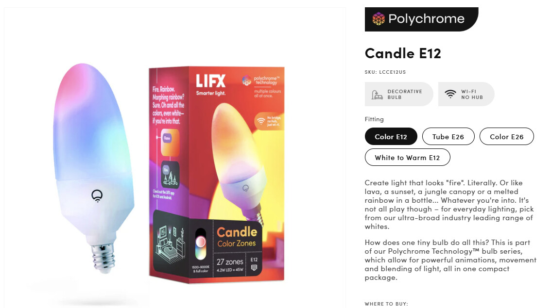

LIFX Polychrome incompatible
That’s also the reason my LIFX Candle E12 only supports a single color rather than all the crazy “draw on the screen” ways of using it like you see in the app and on the website.
Cool color arrangements:

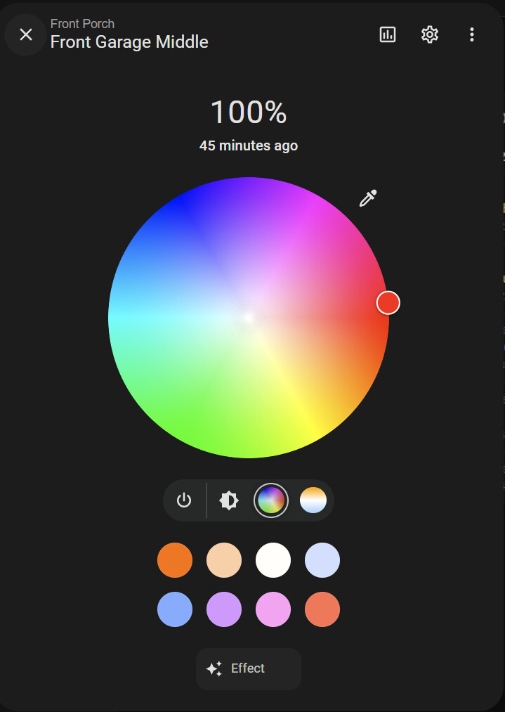

Versus Home Assistant:
