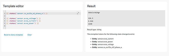

I’ve got the integration working now. I used the Tuya Sensors integration to retrieve the Phase A sensor, and then used Pyscript to transform the data into voltage, current, and power.
https://github.com/koenraadhaedens/tuya-vevor-charging-homeassistant-integration/blob/70e61b33b795e698071253ade02a9a9c7b33c0ac/README.md
