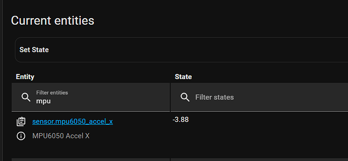

And here is a value that the state is:
And here it is on the dashboard
So it replaced the dot with a comma.
