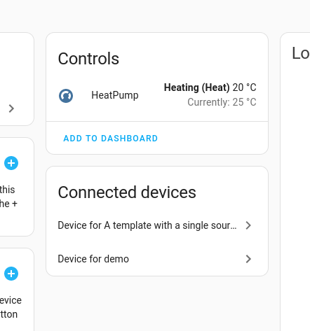

I’ve crafted an attempt at this on ✨ Link template and devices · kamaradclimber/home-assistant@9a92b96 · GitHub.
It works by creating a device for each template defined through the UI. The device is then connected to the relevant device (if all entities referred by the template are from the same device).
The main device has backlinks to all templates:
Each template device has a link to the main device:
This is not as clean as I’d like to (mostly because it creates intermediate devices that make no real sense) but it’s a start.
I’ve created Add template sensors to device page · home-assistant/architecture · Discussion #1054 · GitHub to track the discussion about how it could be implemented in HA.
And a better proof of concept with ✨ Directly connect templates with relevant device · home-assistant/core@dac3f9c · GitHub.
It now connects directly template and the most relevant device.
