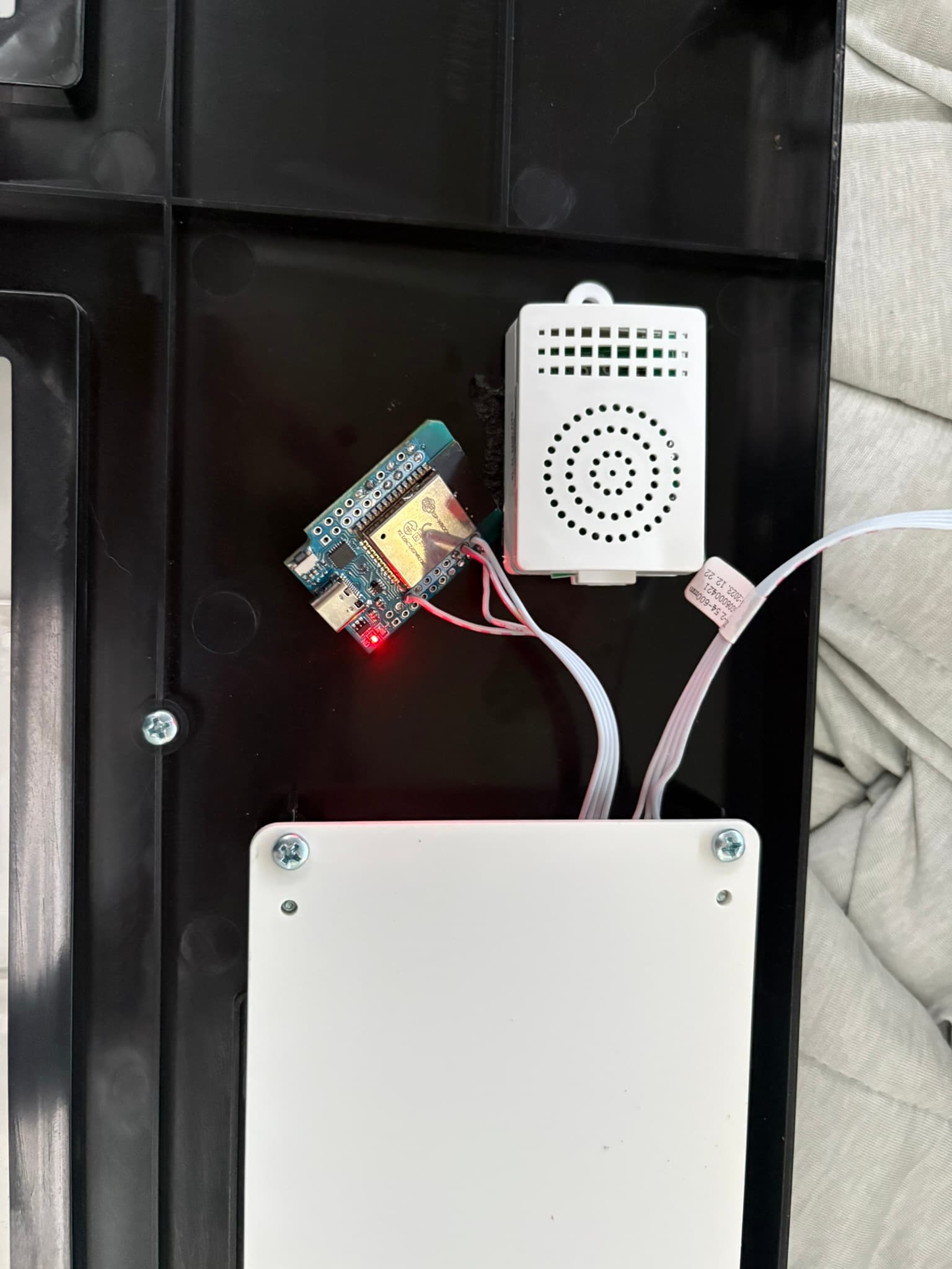

for anyone else looking for this, i have a apollo ERV (Holtop Rebrand AKA Pioneer ecoasis 150). I was able to get it working fully with modes and fan speed using local tuya with the following template. I did not configure pm2.5 as my version doesnt appear to have the sensor as it always reports 0 but its easy to add it to the template if you need it.
- switch:

Check my esphome config for holtop erv.
Thanks for the template, I mistakenly blew away all my local Tuya settings when I got a new mini-split. One simple question though, I’ve been spinning my wheels for an hour trying to load up a template when adding this device but can’t figure it out.
I’ve went so far as adding a /templates directory in LocalTuya and adding an ERV.yaml template based on the one you shared, but I can not figure out how to select it anywhere.
Any help would be appreciated!
So for anyone else whos looking at this, after using my above code for a while, It kept disconnecting every few minutes unless i rbooted the integration. I ended up opening it up ( take unit off wall, unscrew 6 long bronze colored screws from back lift off front cover) and found that the module for tuya is super simple, in its own seperate enclosure and just sticked on with a JST connection with clearly labeled pins on the PCB. So i unsoldered and soldered the wires TRGV board label for Tx RX Gnd and VCC to a esp32. I used the data points i already had setup up above had gemini help me setup the ESPHOME YAML and it just worked. instantly. I love cloud cutting.
Id recommend anyone else with a holtop/apollo erv unit just go this route. Another bonus is you can leave the unit on, but turn fans to 0 speed now (which the tuya module would not allow). This lets me have a continous CO2 reading + humidity.
(yes i should have used different TX RX pins but im lazy)
esphome:
friendly_name: Apollo ERV
esp32:
  board: esp32dev
  framework:
    type: arduino
api:
  encryption:
    key: "nope"
ota:
  - platform: esphome
    password: "nope"
# Using the Silkscreen TXD (GPIO1) and RXD (GPIO3)
uart:
  rx_pin: GPIO3
  tx_pin: GPIO1
  baud_rate: 9600
tuya:
logger:
  level: DEBUG
  baud_rate: 0 # VERY IMPORTANT when using GPIO1/3 to avoid logger interference
# --- DATA POINT MAPPING ---
switch:
  - platform: tuya
    switch_datapoint: 1
    device_class: switch
  - platform: tuya
    switch_datapoint: 108
    on_turn_on:
      - delay: 500ms
      - switch.turn_off: filter_reset_sw
select:
  - platform: tuya
    enum_datapoint: 2
    options:
      0: "Manual"
      1: "Auto"
      2: "Sleep"
      3: "Pure Low"
      4: "Pure Medium"
      5: "Pure High"
sensor:
  - platform: tuya
    sensor_datapoint: 6
    unit_of_measurement: "ppm"
    device_class: carbon_dioxide
    state_class: measurement
  - platform: tuya
    sensor_datapoint: 8
    unit_of_measurement: "%"
    device_class: humidity
  - platform: tuya
    name: "Indoor Temperature"
    sensor_datapoint: 9
    unit_of_measurement: "°F"
    device_class: temperature
  - platform: tuya
    name: "Filter Days Left"
    sensor_datapoint: 11
    unit_of_measurement: "days"
    icon: "mdi:filter-outline"
  - platform: tuya
    sensor_datapoint: 105
    icon: "mdi:alert-circle-outline"
  - platform: tuya
    sensor_datapoint: 18
    icon: "mdi:alert-octagon"
number:
  - platform: tuya
    name: "Intake Fan Speed"
    number_datapoint: 103
    min_value: 0
    max_value: 8
    step: 1
    mode: slider
  - platform: tuya
    name: "Exhaust Fan Speed"
    number_datapoint: 104
    min_value: 0
    max_value: 8
    step: 1
    mode: slider
