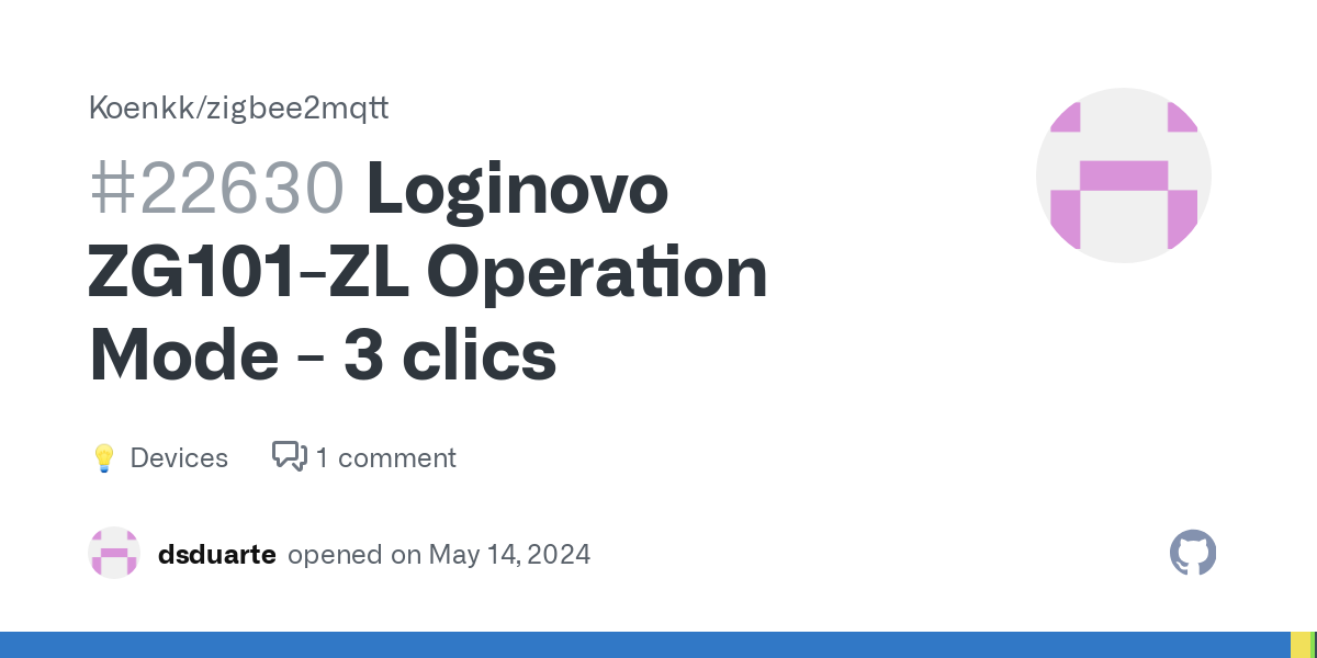

The operating mode is a problem not solved yet and it’s comming from the integration in Z2MQTT. You can find different issues opened in Github to be followed but not solution yet.
The only solution is change the configuration from the button itself with a triple push.
