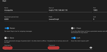

Zwave2mqtt is conigured like this
By entities is see the switch, but can’t control it.
