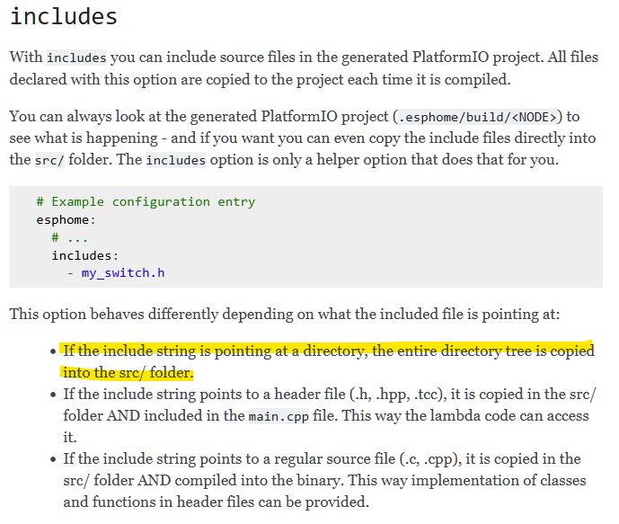

Ah, clearly I wasn’t reading properly. Just testing it now, but it looks like it is in the ‘includes’ section after all.
This was driving me crazy for a few days but I finally found the answer. You can add a library to your ESPHome project from a local folder like this:
esphome:
  libraries:
    - file:///config/custom_src/library    # file://<absolute_path>
    - ./custom_src/library    # This doesn't work!
This is documented in the core configuration. Specifically, it says…
ESPHome accepts the same syntax as the pio lib install command.
In my case, I missed the pio lib link which explains to use the “file://” prefex, which led to me
getting “VCSBaseException: VCS: Unknown repository type…” errors.
