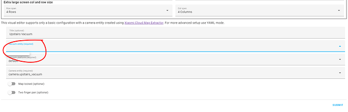

I have added the card and the Lovelace resource.
When i go to add the card it asks for Vacuum entity and my Xiaomi Dreame D9 does not appear?

When you go to Developer Tools > States and type vacuum. at the top of the entity column, how many vacuum devices do you see?
How did you add your vacuums to home assistant?
Hi Tom, Thanks again! So I see both downstairs and upstairs
I used the hacs integration Xiaomi cloud map extractor which is my issue i guess, as it worked for the maps image on the image card. Though it wont pull model and configurations for controls.
I have tried using the Xiami MIIO add on and get this response -
When i then try to configure and look for the Xiaomi Dreame D9 it only shows Roborock models.
Could you tell me what you used to to get it setup please, and possibly any additional code on top of what you have already advised me? Thanks!

No, they are the cameras. Note the dot after “vacuum” in my suggested search:
tom_l:
vacuum.
That should search for devices in the vacuum domain (not the camera domain). But…
That is your issue. The Xiami MIIO integration does not support your model vacuum. There’s this third party integration that may work:
Thanks again! Just tried it, no dice unfortunately, back to map only which is ok, not as nice as what you have going on. Lessons learnt above, thanks!
