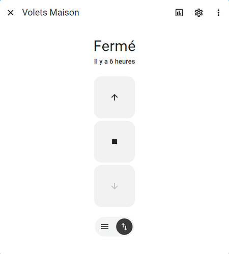

I control my shutters via the Overzik integration, but it can only manage 10 commands at a time as indicated in the doc.
The problem is that I have 12 roller shutters.
So my group which allows me to manage my 12 shutters with all the controls for the shutters does not work very well because I always have 2 shutters which do not activate.
Hence my request to know if it is possible to delay the piloting between 2 components.
PS I tested the automations but they do not allow you to manage all the shutter controls (solid, up, down, stop, etc.)
PS 2: in the group I can only add Shutters type entities
For your information, my Somfy IO shutters are paired with a Somfy connectivity kit

I want to keep the classic roller shutter controls that I have in the group that I created.
The problem is that the control integration of my shutters which is Overzik can only control a maximum of 10 pieces of equipment at a time whereas I have 12 and as a result I always have 2 shutters which do not work together. not operate.
By testing with the automation I was able to see that by inserting a time delay of 30 seconds between the first 10 shutters and the last 2, I had no control problem, and that is why I wanted to insert a time delay between the equipment in my group so as not to have any control problems.
