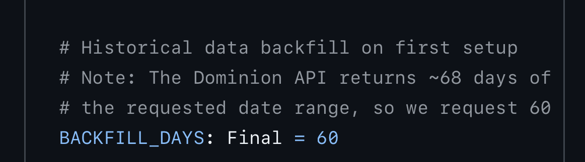

Just installed this and works really well!! Couple questions
  • is it possible to get statistics going back >60 days for the dashboard?
  • Anyone see an issue with it showing Euros as currency in the energy dashboard even though the cost sensor has $
Edit - I just saw this

Just installed v1.3.3 today on my Dominion Energy Virginia account — working great, including the 60-day historical backfill. @YeomansIII thank you for building this, it fills a real gap since Dominion VA doesn’t use Opower.
