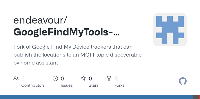

I hacked together a quick script that publishes the location data from GoogleFindMyTools to MQTT so you can see them in home assistant.

Ive tried to run your script, and seems like it was successfull, but im unsure how to see these devices in HA? Ive searched my devices and entities list for anythign i could think off, but no luck, both before and after restarts.
Edit: Never mind, MQTT was configred wrongly on my HA. Thank you for the script! :smiley:
Edit: i was running the main.py over and over and didnt realise that i could just run the publish_mqtt.py to accomplish everything i needed. Thanks!
This is probably a dumb question but I haven’t used scripts a whole lot in Home assistant. How would I install this setup in my Home Assistant? Thanks!
