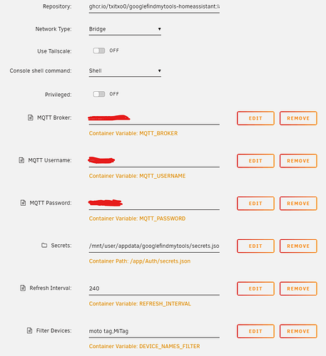

I was able to get the Docker version running. It works quite well. I looked at docker-compose.prod.yml to get an idea. I set mine up in Unraid.

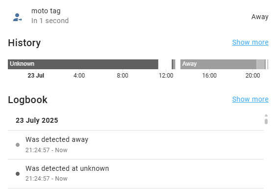

Although every time it updates, it logs as unknown just before its current status.
Yes, the way the script is currently working, it publishes “unknown” as the state, plus the GPS coordinates, and Home Assistant then updates the state based on the GPS coordinates.
