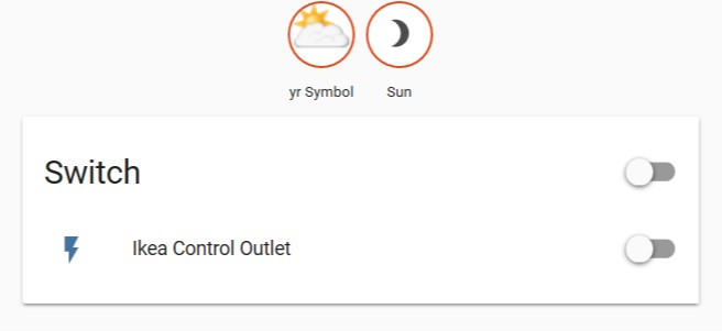

Today I started Homeassistant again and to my surprise I see the Tradfri control outlet is connected to the Homeassistant Overview screen (see below).
Annotation%202019-02-21%20205030
When I press one of the switches I would expect that the control-outlet is switching on or off but nothing happens. The outlet is connected through a CC2531 dongle.
Is there still some extra configuration I need to do to make this work?

In the overview-screen I see the below screen:
