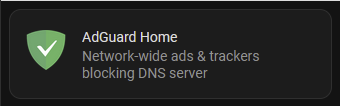

You can install Adguard as a Add-on via HA webinterface.

AdGuard can be installed via Add-Ons
