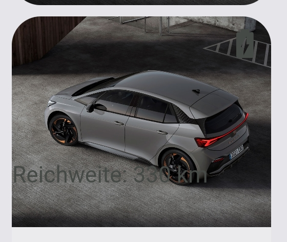

Just to show you what I mean, here’s the diffence between Desktop and Mobile App:
Bildschirmfoto 2024-09-25 um 18.04.44
Screenshot_20240925_180518_Home Assistant
The CSS for the bottom left text is:
bottom: 0px
left: 38%
font-size: 1.12em

Yes, I’m using the default theme on Desktop and ios-light-mode-blue-red-alternative on Mobile.

Why are you using em and absolute bottom?
I also suggest using percentage for the position. The change of text color is because you are using two different themes.

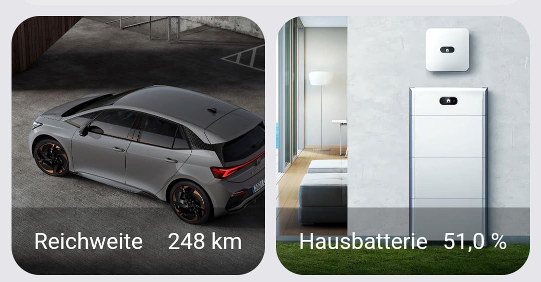

I was able to set the color in the card, but regarding position, nothing is really working. The reason is that the aspect ratio changes based on the viewport. This can easily be tested be resizing the browser window and watch the card stretching in one direction. It’s especially bad with this layout:
