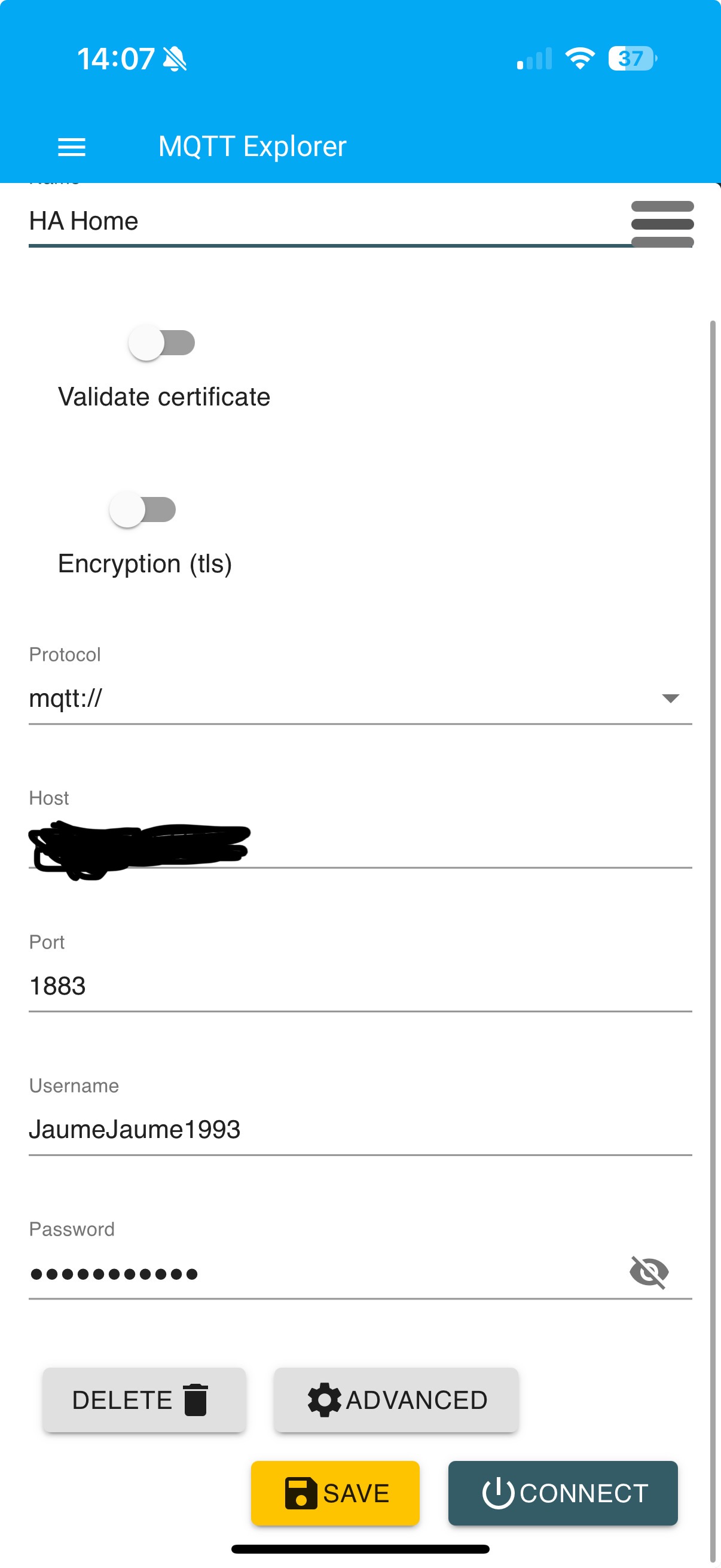

I got a lil problem with the connection between mqtt explorer and ha. I did put HA on static ip, but when I try to connect, it says disconnected from server
Can someone help?
The IP address is the address of mqtt server, not HA. It seems you may be inputting the HA IP address by your comment above.
