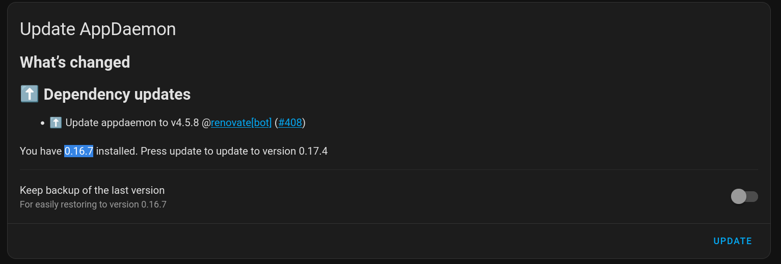

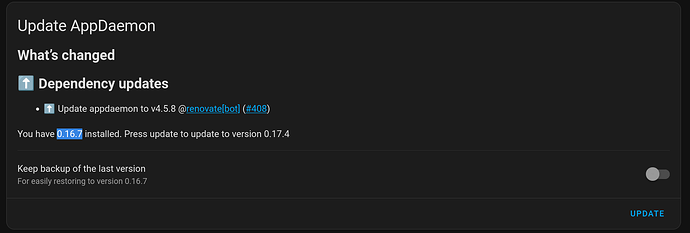

However, on my main instance (aarch64), it keeps proposing only the update to 0.17.4:

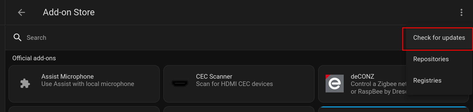

but not the update to the “fixed” 0.17.6 version, and that despite me explicitly refreshing the add-on store:
