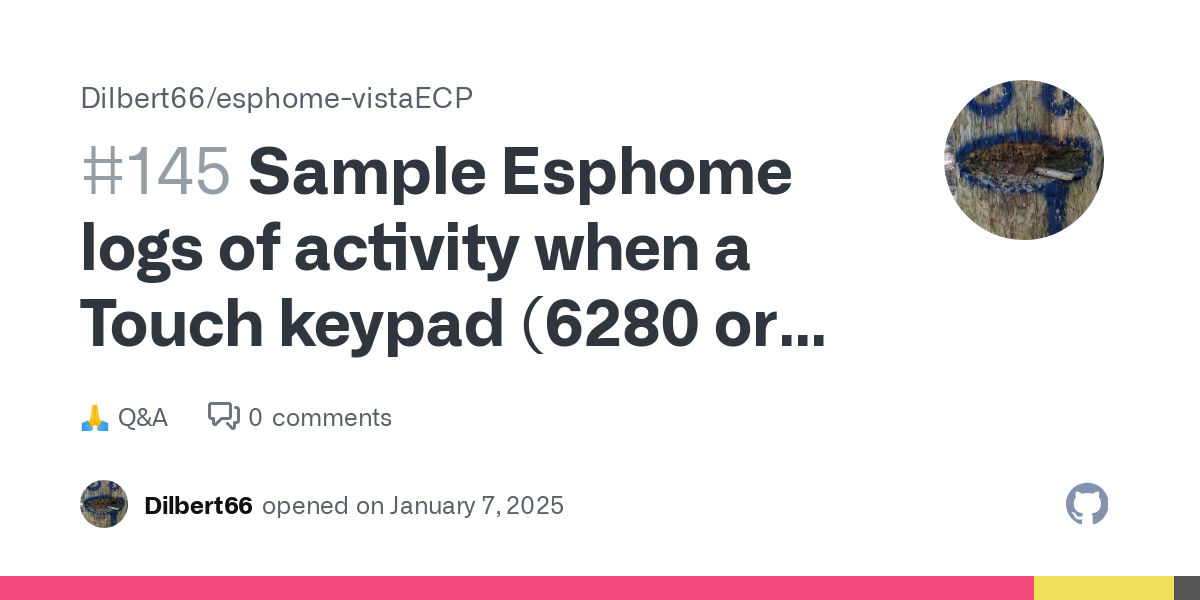

I need to ask a favor of anyone that has a Touch Keypad such as the Honneywell 6280 or the Tuxedo Touch. It would be best if you are also using the “dev” version of the Vista library as it provides more info on the F2 cmds. I need some esphome logs of when the touch keypad is used to view open zones. If you do, can you please post them on this discussion on my github site! Thanks!

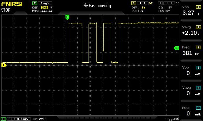

There is something wrong your connection , wiring or circuit as the log shows garbage data. You might also want to use the “dev” version. It does not require the “fix” file.
That’s so strange, since the signals are quite clean.
Here is an oscilloscope shot from the RX pin (@GPIO5):
There is only a slight 200mV DC offset.
The TX and Monitor Pin shots (@GPIO4 and 7) look good as well.
If you need I can post them in the next posts.
