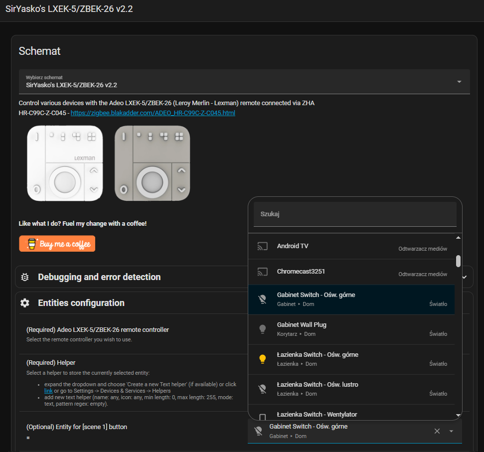

Sorry for my issue but i stuck.
I import blueprint , create helper and i cant select light entities to work. Of course i check remote sending to HA signals. Please explain how make this blueprint to work with rgb ligts .
Ps.
I create automation of course with schema bluebrint butnon this automation missing place to select light entities.
Best regards
