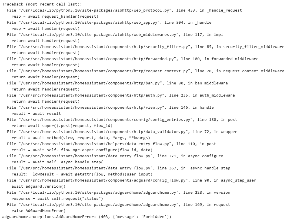

Are there logs I can access somewhere that print when you try and add integrations?
Seems to be 403 forbidden error from the logs:
Which is weird because I am able to log in using the same credentials in the browser UI.
