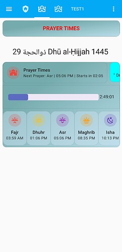

I am trying to use two different layouts for different dashboards, here my other on with error also:
Here’s the code for it:
type: custom:stack-in-card
cards:
  - type: custom:layout-card
    layout_type: custom:grid
    layout:
      grid-template-columns: auto 120px
      grid-template-rows: auto auto
      margin: '-4px 0px -10px -4px;'
    cards:
        primary: Prayer Times
        secondary: |-
          Next Prayer: {{ states('sensor.next_prayer') }} | Starts in         {{
           states('sensor.time_until_next_prayer_formatted') }}
        icon: mdi:mosque
        entity: sensor.next_prayer
        tap_action:
          action: none
        hold_action:
          action: none
        icon_color: red
        fill_container: false
        multiline_secondary: false
        card_mod:
          style:
              ha-card {
                background: none;
                box-shadow: none;
            mushroom-state-info$: |
              .container {
                --primary-text-color: rgba(255, 255, 255, 0.9);  /* White with slight transparency for high legibility */
                --secondary-text-color: rgba(255, 235, 59, 0.9);  /* A soft amber for a warm contrast */
  - type: custom:timer-bar-card
    entities:
      - timer.next_prayer_timer
    layout: full_row
    bar_radius: 5px
    bar_height: 20px
    bar_width: 70%
    bar_foreground: rgba(92, 107, 192, 1)
    bar_background: rgba(237, 231, 246, 1)
  - type: horizontal-stack
    cards:
        primary: Fajr
        secondary: |
          {{ states('sensor.islamic_prayer_times_fajr_prayer') }}
        icon: mdi:weather-sunset-up
        icon_color: '#F44336'
        layout: vertical
        tap_action:
          action: more-info
        entity: sensor.current_prayer
        card_mod:
          style:
              ha-card {
                /* Set size and spacing of button */
                {% if states('sensor.current_prayer') == 'Fajr' %}
                  border: 1px outset green; /* Example border color */
                  background: rgba(70, 130, 180, 0.5) !important;
                {% else %}
                  background: rgba(199, 224, 238, 0.5) !important;
                {% endif %}
                width: 75px;
                --spacing: 8px;
                padding-bottom: calc(var(--spacing) * 1.718) !important;
                margin-bottom: 5px;
                /* Styling of button */
                box-shadow: var(--ha-card-box-shadow) !important;
                border-radius: calc(var(--ha-card-border-radius, 15px) * 1 ) !important;
                /* Center button */
                margin-left: auto;
                margin-right: auto;
                transition: all 0s;
              /* Add subtle color on hover */
              ha-card:hover {
                background: rgba(255, 235, 59, 0.5) !important; /* Soft amber on hover with reduced opacity */
                border-color: orange; /* Orange border on hover */
              ha-state-icon {
                  animation: spin 2s linear infinite;
                {% endif %}
              @keyframes spin {
                0% {transform: rotate(0deg);}
              .container {
                --secondary-text-color: rgba(13, 71, 161, 0.9);  /* A soft amber for a warm contrast */
        primary: Dhuhr
        secondary: |
          {{ states('sensor.islamic_prayer_times_dhuhr_prayer') }}
        tap_action:
          action: more-info
        icon: mdi:weather-sunny
        icon_color: '#FFC107'
        layout: vertical
        card_mod:
          style:
              ha-card {
                {% if states('sensor.current_prayer') == 'Dhuhr' %}
                {% else %}
                {% endif %}
                width: 75px;
                --spacing: 8px;
                margin-bottom: 5px;
                /* Center button */
                margin-left: auto;
                margin-right: auto;
                transition: all 0s;
              ha-card:hover {
              ha-state-icon {
                {% endif %}
              @keyframes spin {
              .container {
        primary: Asr
        secondary: |
          {{ states('sensor.islamic_prayer_times_asr_prayer') }}
        icon: mdi:weather-sunset-down
        icon_color: '#9C27B0'
        layout: vertical
        tap_action:
          action: more-info
        card_mod:
          style:
              ha-card {
                {% if states('sensor.current_prayer') == 'Asr' %}
                {% else %}
                {% endif %}
                width: 75px;
                --spacing: 8px;
                margin-bottom: 5px;
                /* Center button */
                margin-left: auto;
                margin-right: auto;
                transition: all 0s;
              ha-card:hover {
              ha-state-icon {
                {% endif %}
              @keyframes spin {
              .container {
        primary: Maghrib
        secondary: |
          {{ states('sensor.islamic_prayer_times_maghrib_prayer') }}
        icon_color: '#FF9800'
        layout: vertical
        tap_action:
          action: more-info
        card_mod:
          style:
              ha-card {
                {% if states('sensor.current_prayer') == 'Maghrib' %}

Any help is appreciated. Jzk
It did help me a lot and also the automation steps you sent. I am stuck on the time not showing correctly and spacing.
I haven’t managed to get the fancy card to work. But if you are interested I have created a much simpler one:
show_name: true
show_icon: true
show_state: true
type: glance
entities:
  - entity: sensor.islamic_prayer_times_fajr_prayer
    format: time
  - entity: sensor.islamic_prayer_times_dhuhr_prayer
    format: time
  - entity: sensor.islamic_prayer_times_asr_prayer
    format: time
  - entity: sensor.islamic_prayer_times_maghrib_prayer
    format: time
  - entity: sensor.islamic_prayer_times_isha_prayer
    format: time
    icon: mdi:weather-night
state_color: true
title: Prayer Times
`type or paste code here`
This works for me. Thank you so much appreciate it. If someone else have any ideas about how to get the timer please let me know. JZK
For the following card,
The yaml code is:
cards:
  - type: custom:button-card
    variables:
      currentview: |
          return window.location.pathname.split('/').slice(-1);
    entity: sensor.islamic_day
    show_name: false
    show_state: true
    color_type: card
    card_mod:
      style: |
        ha-card {
          margin-top: 1px;
          margin-bottom: 1px;
          margin-left: 1px;
          margin-right: 10px;
          border: skyblue solid 5px !important;
    styles:
      card:
        - height: 3em
        - align: center
        - font-weight: bold
        - background-color: ''
        - color: orange
    layout:
      grid-template-columns: auto 100px

All credit goes @chintito4ever . Try to scroll up and read his post about all the sensors you need to create the card. There is also a timer helper you need to create.
@raub21 I have tried the above code, but I still get errors on the prayers and also on the timer.

Did you create a time_date sensor in your configuration? That might be the issue!
You can create it and add it to your sensors yaml file or to the configuration.
sensor:
  - platform: time_date
    display_options:
      - 'time'
      - 'date'
      - 'date_time'
      - 'date_time_utc'
      - 'date_time_iso'
      - 'time_date'
      - 'time_utc'
Removed ā€œbeatā€ as it is deprecated.
Waalikom salam. Unfortunately, I don’t have a blueprint for the automation. I can share one of my automation for the adhan if that s what you want to see! The prayer card code is listed above.
I forgot to mention to reboot the server after creating the sensors!

Any idea how do I get rid of the unsightly thin margin lines? I tried fiddling with the margin numbers but that didn’t help.
scroll up and find posts from @chintito4ever and @cob94440 ! I copied their code to enhance mine. Hope this helps you!
