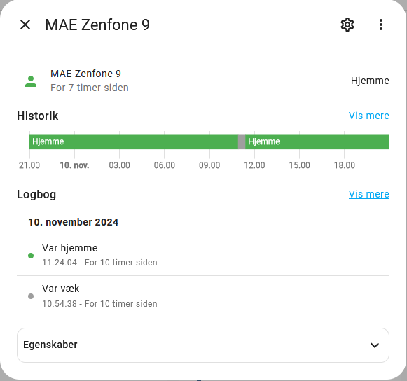

Hi @op00
I have now “monitored” the automation for sometime and in the last about 17 days it have failed me 4 times since google released the update to the “alarm app”
every time it fails the automation trace is saying that the automation takes “option1” but it seems that “option1” is something in the blueprint and not my “actions”
it failed these times
1= 31 okt
2= 4 Nov
3= 6 Nov
4= 10 Nov
but it seems random so i have not been able to find the root course other than
the google app update. and before i updated to android 14 i was the same “instability”
but after upgrading to android 14 and before the new google time update it was rock solid.
hope this info is useful
Thanks
/Martin
