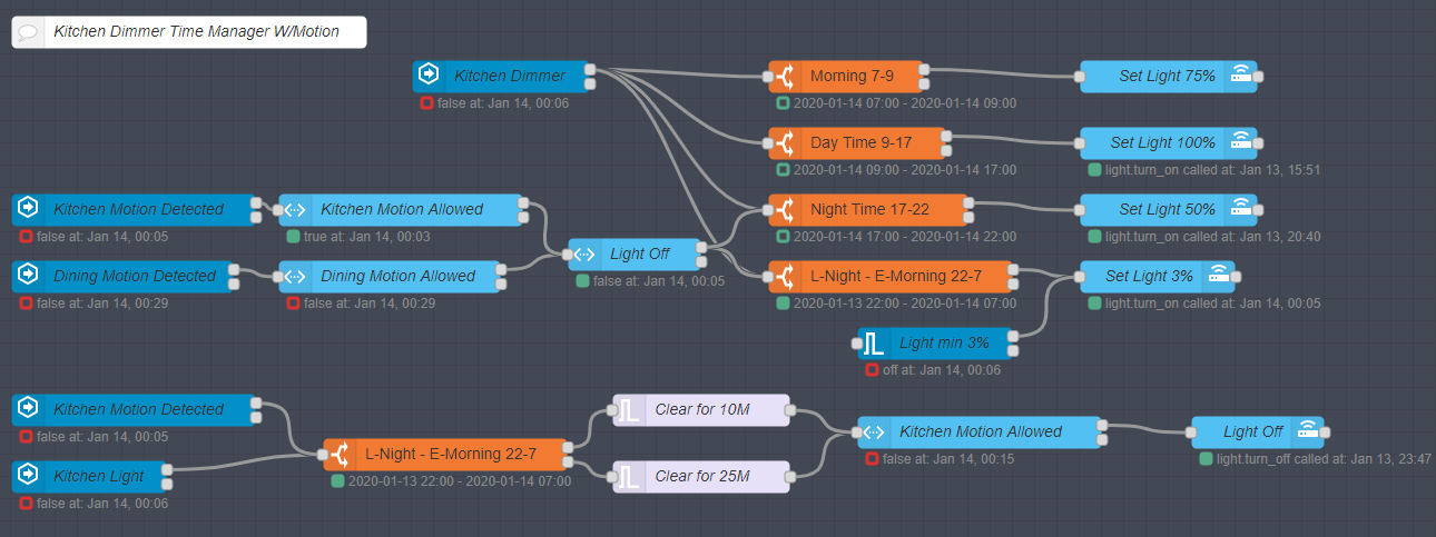

Here is my Dimmer Manager
Basic config
Data Config

Doranagun, your Node-Red page is very impressive and I have not learned that tool yet. I will try to implement the “basic config” you offered, thank you.

You don’t so much have lovelace do it unless you want multiple ON buttons each with a different value. You can use automations to do it based on time similar to my node-red flow. just in automation. Trigger is state OFF changes to >0 (greater than 0)
Condititions would be a time window X to Y. resulting in the brightness_pct: XX being run against the light entity.
WHen I started getting into HA 3 months ago i looked into automation methods I found the “Automations” needlessly… difficult. NR is easier once you work out its idiosyncrasies. Its by no means simple… but you can make it do things with many more steps and actions than the automation screen allows. Programming it in YAML is for the ubernerds around here.

Ahh… looking at those they only work under full YAML edit mode… Ubernerd Mode. that is beyond me as of yet.
I’l stick to my nodered time windowed dimmer manager.
