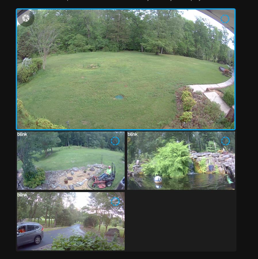

If you use the advanced card you’ll know it only displays a vertical stacked grid using that yaml.
I have 10 cams, I want it Horizontal / Landscape – not vertical.

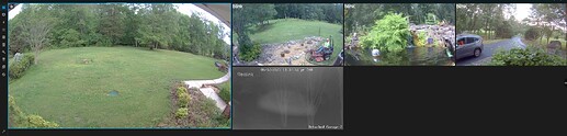

A bit combative, I have advanced card installed. How about a primitive image of what you want? Stating you want a landscape vs a vertical grid is not intuitive.

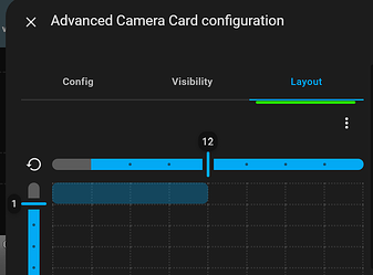

Ha cards are limited in width unless the dash view is changed. Card mod can be used to manually adjust the main card’s width.
The main card does have card dimension options
You will most likely need to use Panel mode with the card’s grid option
Thanks for the help. It would help if you can post the YAML you used to do the lower, horizonal display, that is what I need for the tablet 16x9 landscape view. I love the functionality of the ACCs built-in grid and just want to “turn it landscape”

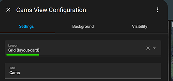

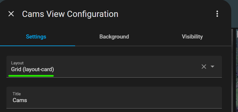

Test this code :arrow_down: You’ll need
  1. custom:layout-card
  2. Create a new view using Grid(layout-card)
  3. Add the custom:advanced-camera-card
Card Code

I’ve done a lot of testing with different YAML. I could not get anything to scale rows/columns to the actual limits of the display resolution / dimensions.
Seems the Advanced Camera Card’s internal grid does not allow for this. Layout Card is just a wrapper with no influence on who ACC’s grid works; which is why layout card’s Panel type allows it to expand BUT Panel still does not auto-scale to the actual display boundaries.
I’m going to put in a feature request. I’m really surprised this card, as awesome as it is, doesnt have a way to automatically fill the screen limits.
