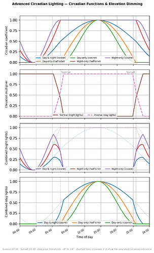

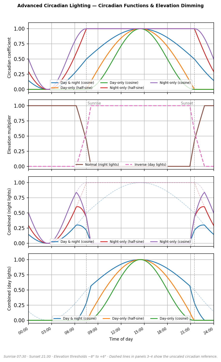

This blueprint adjusts light brightness, colour temperature, and colour hue based on time of day and sun position, with optional presence and sleep control. Lights follow circadian curve, scaling smoothly between configurable day and night values, as shown in the figure below.
Circadian functions define how the main circadian coefficient — a value between 0 and 1 — varies over 24 hours. When the coefficient is 0, lights are set to the configured night brightness, colour temperature, and hue. When it is 1, they are set to the day values. Five functions are available:
  • Day & night (cosine): active 24 hours. Reaches 1 at the middle of the day and 0 at the middle of the night, with a smooth continuous transition throughout.
  • Day-only (half-sine and cosine): stays at 0 between sunset and sunrise, then rises to 1 at the middle of the day and returns to 0 at sunset.
  • Night-only (half-sine and cosine): stays at 1 during the day, then drops to 0 at the middle of the night and returns to 1 at sunrise.
The half-sine and cosine variants produce slightly different curve shapes — the cosine has a smoother, more gradual transition between night and day values, while the half-sine is more prominent.
The circadian cycle can follow fixed configured times or actual sunrise and sunset from your location.
Colour hue cycles continuously through the colour wheel over 24 hours — red in the middle of the night, through orange, yellow, green, blue, and purple during the day, and back to red. This applies only to lights currently in colour mode. A default fixed hue is available as fallback when the circadian function is disabled.
Elevation-based dimming (optional) adds a multiplicative brightness scaling as the sun crosses configurable elevation thresholds. In the case of night lights, before sunset, when the sun is above the upper threshold, lights are off. As it drops through the sunset window toward the lower threshold, the elevation coefficient ramps from 0 to 1, and the actual brightness sent to the light is circadian_brightness × elevation_coefficient. This gives a smooth, gradual turn-on at sunset and can be accordingly configured for a smooth turn-off at sunrise, rather than an abrupt switch. An inverse mode is also available for daytime lights that should be on when the sun is up.
