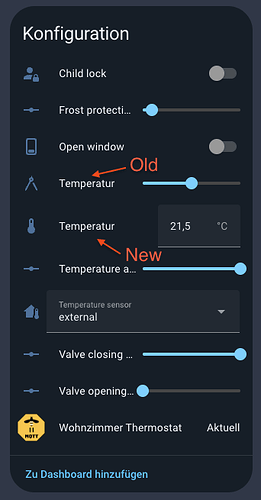

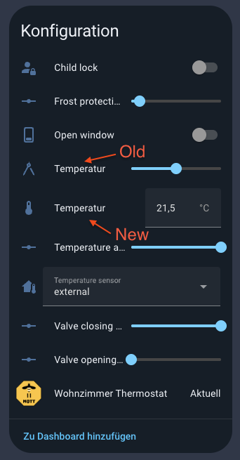

I own the same. Here is my configuration:
Old Keyword:
Bildschirmfoto 2025-11-24 um 10.41.44
New Keyword:
Bildschirmfoto 2025-11-24 um 10.42.13
Donโ€™t forget to set the old local temperature calibration entity to 0 and maybe rise the accuracy slider for a more accurate result:
