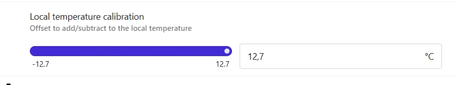

@kartname
Could you use share the trace log for example here? Just share the link here.
Today the external temp got not updated (and the TRV stayed at 100% all the time) for 5h. 5h ago was probably the time i installed the HA beta.
After going back to 2025.12 it working again.
Yes, there must be some errors in your home assistant log:
ValueError: Template error: float got invalid input 'unknown' when rendering template '{% set n = namespace(dict=[]) %}\n{% if is_native_calibration_trigger and is_calibration_enabled %}\n  {% for valve in valves_calibration_common %}\n\n    {% set calibration_entity = device_entities(device_id(valve)) |\n                                expand | selectattr('domain','in','number') |\n                                selectattr('entity_id', 'search', input_calibration_key_word) |\n                                map(attribute='entity_id') | list | first | default(none) %}\n\n    {% if calibration_entity is not none %}\n\n      {% set calibration_entity_min = state_attr(calibration_entity,'min') | float %}\n      {% set calibration_entity_max = state_attr(calibration_entity,'max') | float %}\n      {% set calibration_entity_value_old = states(calibration_entity) | float %}\n      {% set local_temperature = value_temperature_sensor | float %}\n      {% set calibration_entity_value_new = local_temperature %}\n      {% set is_offset_entity = (calibration_entity_min + calibration_entity_max) == 0 and calibration_entity_max < 30 %}\n      {% set calibration_select = none %}\n\n      {% if is_offset_entity %}\n        {% set thermostat_temperature = state_attr(valve, 'current_temperature') | float %}\n        {% set calibration_entity_value_new = (-(thermostat_temperature - local_temperature) + calibration_entity_value_old) %}\n      {% else %}\n        {% set calibration_select = device_entities(device_id(valve))\n                    | expand\n                    | selectattr('domain','in','select')\n                    | selectattr('attributes.options', 'contains', 'external')\n                    | map(attribute='entity_id') | list | first | default(none) %}\n      {% endif %}\n\n      {% set calibration_entities = device_entities(device_id(valve)) |\n                                expand | selectattr('domain','in','number') |\n                                selectattr('entity_id', 'search', input_calibration_key_word) |\n                                map(attribute='entity_id') | list %}\n\n      {% set step = state_attr(calibration_entity, 'step') | float(1) %}\n      {% if rounding_mode == 'manual' %}\n          {% set step = input_calibration_step_size | float(1) %}\n      {% endif %}\n\n      {% if is_aggressive_mode_calibration %}\n        {% set temp_diff = state_attr(valve,'temperature') | float(target_temperature) - local_temperature %}\n\n        {% if temp_diff * factor < input_aggressive_mode_range * -1 %}\n          {% set calibration_entity_value_new = calibration_entity_value_new + input_aggressive_mode_offset * factor %}\n        {% elif temp_diff * factor > input_aggressive_mode_range %}\n          {% set calibration_entity_value_new = calibration_entity_value_new - input_aggressive_mode_offset * factor %}\n        {% endif %}\n      {% endif %}\n\n      {% if step <= 1 and calibration_entity_max | float < 1000 %}\n        {% set round_size = iif('.' in (step | string), (step | string).split('.')[1] | length, 0) %}\n        {% set calibration_entity_value_new = ((calibration_entity_value_new | float(0) / step) | round(0) * step) | round(round_size) | float %}\n      {% else %}\n        {% set calibration_entity_value_new = calibration_entity_value_new * 100 | int %}\n      {% endif %}\n\n      {% set calibration_entity_value_new = iif(calibration_entity_value_new > calibration_entity_max, calibration_entity_max, calibration_entity_value_new) %}\n      {% set calibration_entity_value_new = iif(calibration_entity_value_new < calibration_entity_min, calibration_entity_min, calibration_entity_value_new) %}\n\n      {% set is_min_difference = (float(calibration_entity_value_old) - float(calibration_entity_value_new)) | abs >= float(input_calibration_delta) %}\n\n      {% set keep_alive = false %}\n\n      {% if is_calibration_trigger and not is_min_difference and device_attr(valve,'manufacturer') in keep_alive_manufactures %}\n        {% set last_updated = [calibration_entity] | expand | map(attribute='last_updated') | first %}\n        {% set keep_alive = as_datetime(current_time_stamp) - timedelta(minutes=20) >= last_updated %}\n      {% endif %}\n\n      {% if is_min_difference or keep_alive %}\n        {% set n.dict = n.dict + [(valve, [{ 'calibration_entity': calibration_entity,\n                                              'value': calibration_entity_value_new,\n                                              'select':calibration_select,\n
I dont’ know exactly whicht entity is in unknown state but this fires an error. Because all values here are necessary for calibration it doesn’t happen in your case.
https://pastecode.io/s/xrkw3fwe

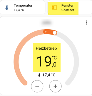

This issue seems fixed now and i tried version 5.5.0_a4 since 3 hours,
But now heating will not turn off, if the windows is open.
Sry, another update should solve the problem. :grinning:

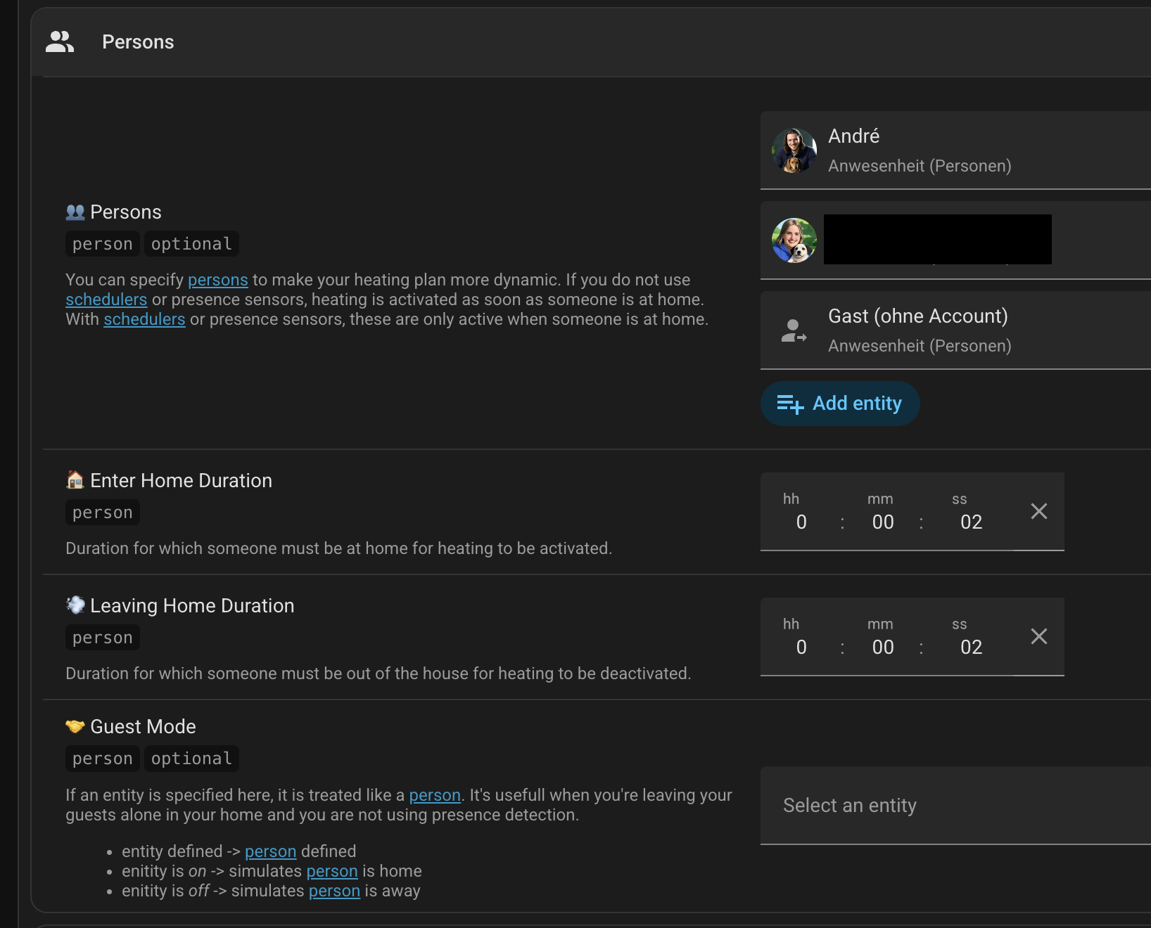

I just realized that if multiple persons are added to the automation, the heating will only turn on if both are at home, so effectively this is an AND logic. I would appreciate it if this could be switched to a OR logic. At least optional. I want the heating to turn on if anybody is at home
@Tomibeck I don’t think that’s true. For me it is “if at least one is home”. Here’s a screenshot of my sensor with currently 1 person being at home:

Nope, comfort kicks in if at least one person is at home. Eco when nobody is at home.

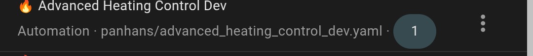

@panhans Do you have removed the dev Version? :see_no_evil:
Can you put it also in the dev Version? Than i can Test simultan. :see_no_evil:
Yes, since I worked on a dev branch this doesn’t fit to my workflow. But I’ve just restored it. :wink: Try again.
