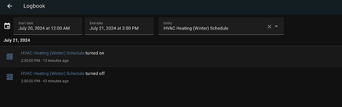

Hi. I’m seeing some strange behaviour over the last few days. I’ve tried to identify cause but not clear to me yet. I’ve added the latest version.
Having issues with schedule triggered heating and the heating schedule adjustments functionality.
Here is an example today with log entries etc…
Schedule set to heat at 2:30. Log entry for the schedule shows the schedule triggered at 2:30 (trace attached and log screenshot). AC entity log did not show it changing state until I manually did at 2:37pm, but I see an event in the advanced heating control automation (see link below to trace).
Also, I set a manual schedule adjustment to change comfort temp to 19c at 2:38; the log entry for the AC thermostat entity shows it turning to off and then heat but no temp change.
I’ve had this working reliably for many months and something has clearly changed - but cannot detect what / why yet.
Help appreciated! Thanks

Yeah, I had the guest mode as I originally had a person set and the guest was to disbale that in case other were staying over when I’m not in the house, but have removed that.
Cause seemed to be my intesis box which routinely drops (cant fix, is old). Reboot seems to have brought it back to life - whenever that dropped the automation became ‘unavilable’ and nothig triggered.
Longer term, might need to move the intesis to working via MQTT, or something that queues at any rate…and is always an available climate entity.
