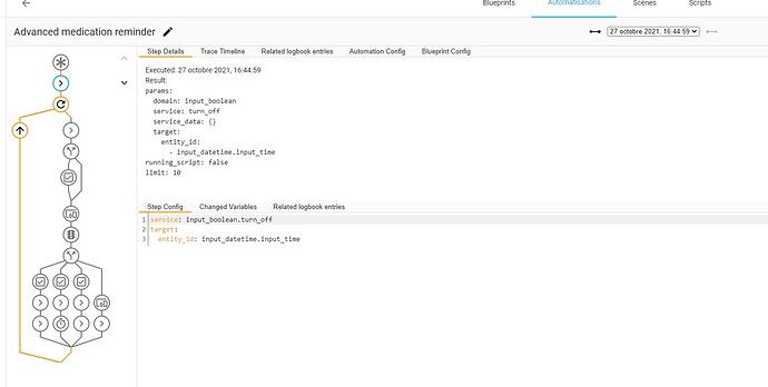

I use this blueprint but i dont receive any message on my phone ?
I dont understand why is not working
All is ok in my configuration
Can you help me please ?
Thanks in advance
You’ll need to show the automation config and/or the step details of the notification action. MIght also upload the trace (the down arrow button near the top)
