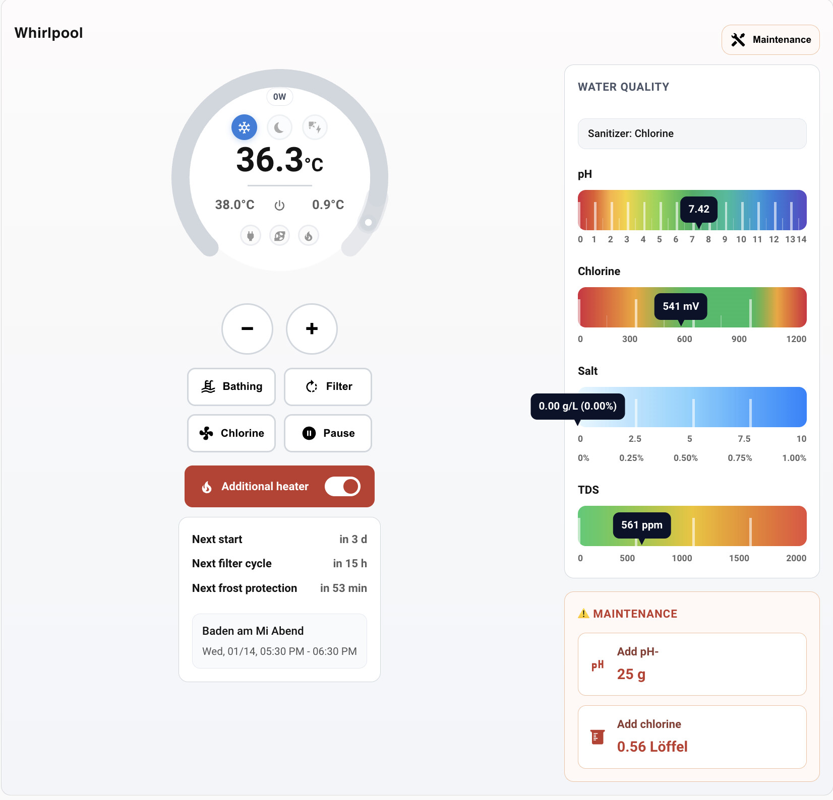

English Example:

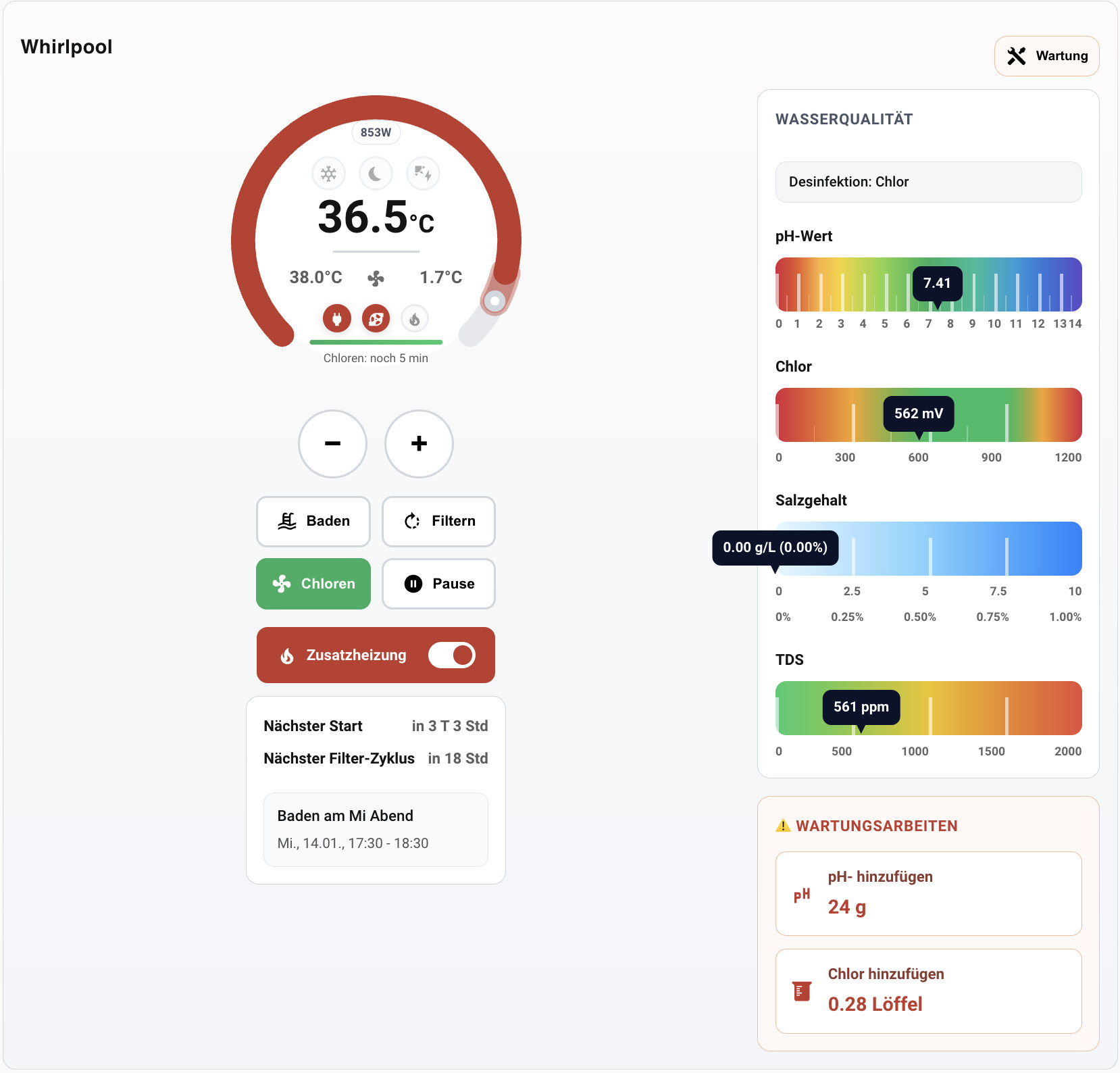

German Example:

What it does
  • Provides a single “controller” climate entity (setpoint, min/max/step, preset modes) to run the pool/whirlpool automation.
  • Drives real switches via a coordinator/state-machine approach (the coordinator is authoritative).
  • Exposes sensors for water quality and automation status (pH, chlorine, salt, TDS, PV, quiet hours, frost protection, timers, power usage).
  • Includes a modern dashboard card with a dial-based temperature control and action buttons.
Key features
  • Manual action timers: Bathing, Filter, Chlorine, Pause
  • Maintenance mode (“hard lockout”): disables automation (including frost protection) and disables controls in the UI
  • Quiet hours support (neighbor-friendly behavior)
  • Frost protection duty-cycle with an “only in extreme cold during quiet hours” override
  • PV surplus integration (optional): can allow heating/filtering only when enough PV surplus is available
  • Frontend uses backend-provided min_temp, max_temp, and target_temp_step automatically when the climate entity exposes them
  • Multi-language UI strings (currently de/en/es/fr)
