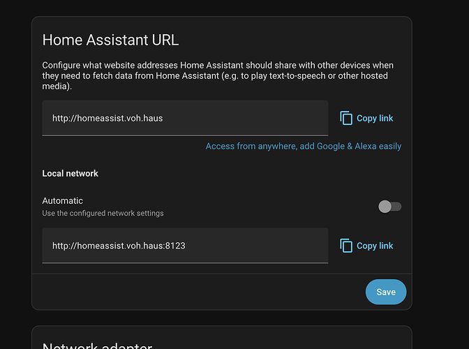

Hm, I updated those settings
But when I open the app it only offers me the ip address not the fqdn. Though I still can login by manually entering the fqdn.
